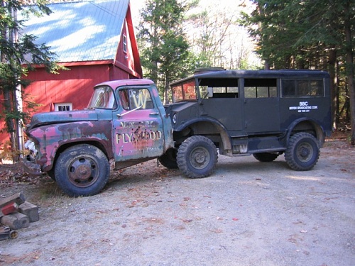

Default Short range recovery of cab and chassis
Hi Guys
Sorry I could not resist.
Name:	Copy of 261 engine 10-27-06 013.jpg
But it actually worked to move the cab and engine into the shop to remove the engine, a 261 that is now in my C60S. Chained the truck chassis to the towing eyes on the bumper of the HUP and drove it into the shop.
Yes, you can remove the cab complete with steering column, but be very sure to slide assembly up into the cab and secure it very well so that you have no risk of bending the shaft. The risk is bending or breaking at the instrument panel bracket. Obviously you also want to be very careful that the wheel or arm are not turned quickly so as to hit the end of travel. As I remember there are no stops so all the strain goes to the recycling balls in the steering box which can be damage easily.

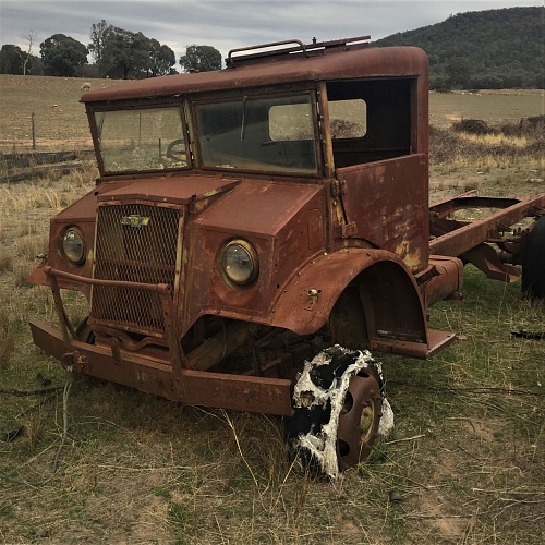

Default Cab in question

Thanks for those responses - here is pix of the offender ...
1) is the front axle and or wheels original?
2) So can the cab be safely transported on its back - say on a piece of carpet, or am I likely to damage it under its own weight etc.?
- Dave - (or Andrew)

Posts: 2,323
Please take my answers as Canadian, not 100% applicable to the Australian situation.
If you have access to the whole truck, not just the cab, don't let the remaining parts go to waste after you take the cab.
The fuel tanks look worth saving. Even if they are useless for fuel and beyond repair, the filler neck and other parts should be saved to permit recreation of new tanks.
In Canada, I would say the wheels were non-original but I believe in Australian service tippers used a similar looking wheel when fitted with dual rear wheels. The transfer case shows a PTO which is consistent with the tipper idea or might be for a winch, what can you learn from the rear of the frame.
From what I can see, the front axle appears typically CMP.
The bumper could probably be straightened in a press, the brush guard could be used as-is or straightened, the tow ring on the bumper often gets left off when people remove and reinstall the bumper.
In short, the list of potentially useful parts never ends so if you don't need or want the whole truck or don't have the means to move it, please let others know how to get hold of parts they might need. If you have the truck sitting, you will be amazed how useful it is as a reference or parts source. Once it has gone to the crusher, it is truly gone - forever.

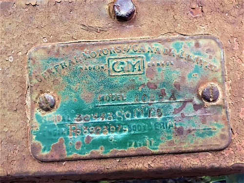

Default Not going to waste

While we are talking Canada etc. - what's anyone's take on the two plates in pix? - Holden one on engine cover, Canada above dash.
Thanks again for all input, much appreciated.

Old 15-08-18, 13:51
Posts: 2,323
The simplest explanation I can think of for the conflicting plates of is that parts have been exchanged between trucks. I don't have the full list of the differences between Australian and Canadian manufactured cabs but based on the ventilators, suspect that at least part of your cab is Australian.
When I mentioned the rear of the frame, it was because there might be holes or paint shadows suggesting either mounts for the tipper body or a winch to give an idea what the truck might originally have been.
I don't know enough about the number on the "model" line of the Canadian plate to use that as a starting point for further speculation/fact.
That style Canadian plate is more typically found on early production than late. I have certainly seen them on cab 13 trucks but in one case wonder if all previous owners have been honest due to the location of the plate.
