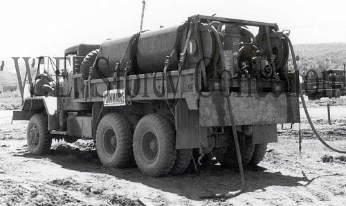

I was hoping that someone here would have some detailed pictures of the Canadian M813A1 with the skid-mounted fuel tanks. I am looking for any pictures of the CF amendments on the truck. This is for a 1/35 model project I'm working on. Thanks in advance.

This image taken during RV 81 may help you out.
33-31 M813 5 ton Truck with Fuel Pods-rear left view, RV 81, Petersville, CFB Gagetown, 1981 cop.jpg

Don't forget to put the "hoodscoop" on the Canadian 5 ton hoods. Basically it was a sheet metal cover to cover the jake brake modification to the engines.
Old 03-04-20, 22:51
Posts: 1,742
Default Jacobs Engine Brake
From the Modification Instruction I have in my collection (C-30-470-000/CF-20), the Jacobs Engine Brake wasn't installed until 1983. The vehicle in my 1981 photograph does not have the signature engine hood assembly.
Old 03-04-20, 23:56
Posts: 7,644
That was about the year I remember doing them.
Looking at your photo, it is not hard to see why transport Canada eventually decided that those tenders did not meet the standard. As I recall they were single wall tanks, and merely cargo strapping them in place hardly seems overly secure.
