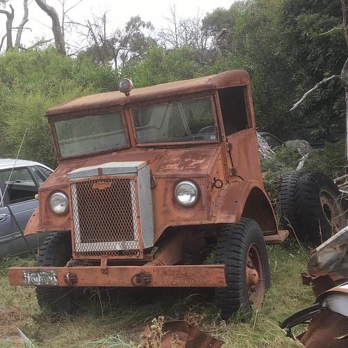

Hi all, apologies for the vague title for this thread. Truth be told I am not really sure what I have gotten myself into and would appreciate any help identifying these two rigs.
I have always loved "Blitz" trucks. Couple that with my love of anything with a transfer case and well, here I am!
The first one is the most complete. Ex South Australian Fire Austhority truck with sunshine roof. Unfortunately the plate they have welded along the chassis for bracing and strength has covered the chassis number.
It is running a Falcon straight 6 and auto! As you can see the nose has been extended to fit the ford 250.

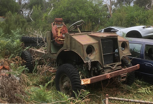

The second is a longer wheel base but has had the rear diff moved forward. It has a chev 6 in it and is also running a PTO. This one is missing the roof but is less molested. Its chassis number is 38444 ?0
Have you measured the wheelbase? Does the work in moving the diff forward look homemade or possibly factory?
8444 is the chassis code for a C15A with a 101" wheelbase. A C15A should have 16" wheels, but those 20's look very much at home on that truck. The cab is set up for Australian canvas doors. With the presence of the winch and the absence of a roof, this could possibly be mistaken for a Gun Tractor, although a Gun Tractor chassis should be 8440 and that cab set up for canvas doors rules it out.
Nice to see good trucks can still be found in the bracken fern!
Thank you Tony. I have found some of Tim Lovelock's (PO) posts. It appears the diff has been moved forward and bolted not riveted.
The replacement engine is an interesting departure from the original wartime driveline. It is a part of the history of that vehicle, and in some ways should not be reversed. In your situation, I would scrape and paint and rebuild it as a Fire Authority truck circa whatever year you choose. Likely whatever the SN of the engine tells you.
No one here will critique your workmanship or your intent. Especially if your intent is to have a functioning spare vehicle for off roading.
Thank you Terry. I like your thinking on that. Thanks for the positive words.
I am normaly very much convinced that historic vehicles should be restored to the state in which they left the factory but I think thet Terry's post above makes a lot of sense. It would also be a really nice vehicle to drive with the Ford 250 and auto box and the auto box should avoid damage to the original power train by reducing shock loads. With the bigger wheels it would also be usefully faster. Come to think of it you could paint it black with flames on the doors...... (No, please don't !)
Pink flames it is then!
