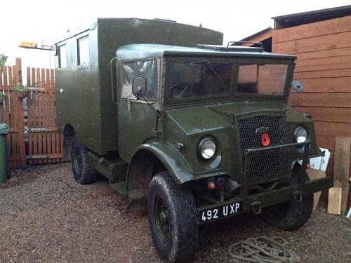

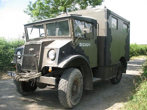

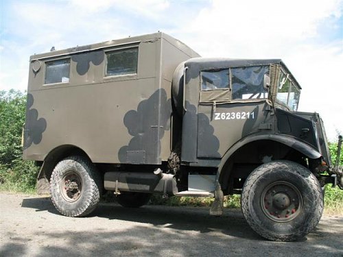

Hi,
I am new to the forum, so Hello to all and thanks for letting me join.
This is my first CMP which i bought through milweb, its been discussed on this forum before, back in july 2010, under the heading of "new CMP Owner". The Consensous of opinion, seemed to be that it started life as a HUP and at some stage was lengthened. The wheel base at present is 120". My intention is to return it to a HUP, if that is how it started life, so any Help would be gratefully appreciated. It is a major operation as, apart from the chassis, there is little left of the original vehical and what is left has been badly restored using wood where the steel has rotted away. Anyway to start with ive attached some pictures from the last post in 2010 and one of as it is today and yes the camera can lie but i love it just the same.
Your opinions would be appreciated.
Jonathan

My opinion is that you would be OK if you have access to and are handy with sheet metal (at less than full shop rates) and providing the frame can be made safe. These bodies are all angle and sheet metal but to build a body from scratch would be a lot of work. I has been done though. You'd have to consider new made doors (with a pressed star on pattern on the inside if you are a purist) and cast hinges for them as well. The other big missing piece is the sliding roof hatch that is complicated and has a batch of cast parts. The rear body has bench seats and expanded metal bins that wouldn't be too hard to make. In the end you'd have once of the nicest CMP's out there.
What's the body you have on there now? Is is a Brit. wireless Body? Is there anything left on the inside? There might be other desirable options...

Hello Bruce and thanks for the reply. I know its a lot of work but i am confident that i can tackle it. The hardest part, to start with, is obtaining information, dimensions and detailed photos that are good enough for me to scale from if the actual dimensions are not available. I have already collected many photos from the net that show how the body was constructed, although all of these are from past renovations and not original factory pictures they give enough information but of course, lack dimensions. Its going to be interesting.
The back is apparently off of a Austin K9 and has been stripped out and reequipped as living space. I dont know how much it weighs but judging by the weight of the back door, quite a bit and it dosnt appear to be doing the rear springs any good. As i say its going to be interesting, so any help, how ever little, will be appreciated and if anyones got any front seats and bases for sale then let me know.
Jonathan

Congrats on the purchase. Indeed your truck has been discussed a number of times on this forum. Even though it's a mix and match I quite like the look, but than again from what I have heard the conversion is pretty rough (?). Anyway, converting it back to a HUP might not be easy, but I agree it is a worthwile project. (a lot of the restored HUPs you see nowadays have partially scratchbuilt bodies as a lot of them were cut into Pickups in post-war life)

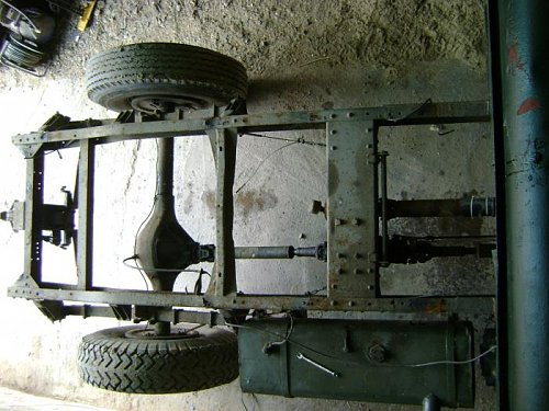

Default HUP project started at last
Hi All,
Well after some considerable time i am ready to start rebuilding my CMP HUP. I had a couple of other projects to finish first, a VW Kubelwagen and a DKWSB200 motor bike, both of which are now complete. So its on with the HUP.
Just to recap. I bought the vehicle some months ago, the chassis had been lengthened by about 18" and a radio body welded to the back. I put some pictures on this site and the consensus of opinion was that originally the vehicle had been a HUP. I ve removed the radio body and the old girl is now in the dry. The first job was to remove the fabricated back to the cab and see what was left of the original body work. Ive attached some pictures, one of which is the pillar behind the front doors, it shows signs of having a set of hinges attached. This is apparent on both sides of the body.
My next job is to shorten the chassis but more importantly, i need to start planning to build the floor structure. Ive collected lots of pictures from the net so i know what it looks like but what i really need, are dimensions, from strut to strut, corner radii and anything else. So if there is anyone who has this information or can tell me where i can get it i would be very grateful.
Jonathan

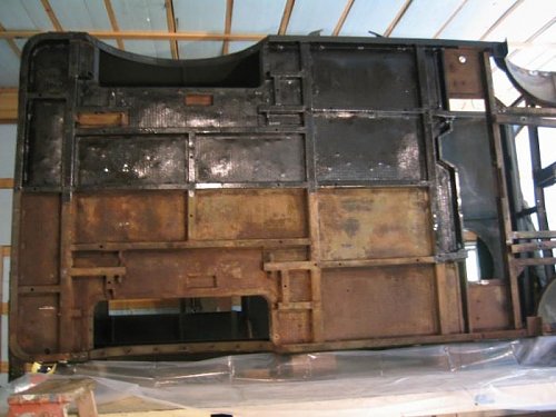

I thought after i had posted it that i had better put a picture of the floor structure so that you all know what i am talking about. Thanks in advance and ill try and keep you all posted as i go along.

Default If you need more photos of the under floor
Hi Jonathan
If you need more pictures or higher resolution for more detail let me know and I'll post them.

Thanks for the reply. If you have got any high resolution pictures of the base structure or any other aspects of the vehicle then they would be more than welcome. If you want me to pay for the postage etc then just let me know.

The old girls been finished for a few months now, that is apart from some proper windscreen frames, as I cant find the right profile steel. I have just been waiting for the weather to improve to take it for a test drive and the big day came about 2 weeks ago. I drove it for about 100 yards and lost all drive, so I put it in 4 wheel drive and crept home. Now, although I had stripped the rear axle down and replaced all the seals and bearings, I only gave the half shaft a cursory glance, they seemed ok so leave alone. It transpires that the long shaft had previously snapped and been repaired, or more correctly bodged, I suspect in order to sell. I have searched high and low for a shaft in the UK and the EU with no luck and I have to admit, that although the likely hood of me ever breaking another one is very slim, not having available spares for the future concerns me. So, I have taken the plunge and I am having new two part half shafts made in the UK for both sides. These will consist of the shaft and a separate splined driving flange. Unfortunately but predictably, the flange will have to be thicker than the original and I will make an end cap to replicate the look of the original but its better than not being able to use the vehicle. Its will be about 8 weeks before they are ready so I will let you know what happens.
The company manufacturing the parts, if anyone is interested, is Rakeway Engineering in Cheadle Staffordshire. They make parts for competition 4x4 vehicles and apparently have a very good reputation for quality, from what I saw the components that they make look very good.
Other than that and a few adjustments all went well.... ha ha.
I have realised that I haven't posted any pictures of the finished vehicle with its new tyres, an error that I will correct in the near future.
Jonathan

Onwards, forwards and backwards.
