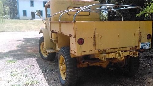

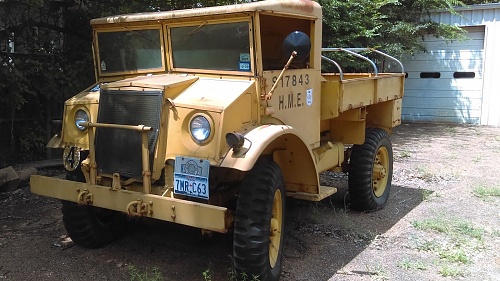

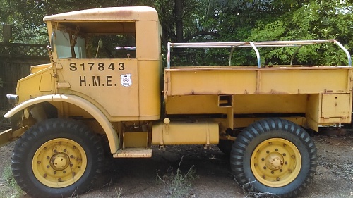

Pics attached. Please let me know what other views would be helpful.
Appears to be a 1943 Type 13 Ford, VIN 152674.
I understand it was a forest service truck, rescued in B.C. by some snowmobilers who sledded in an engine, by the name of Robert McAleny and Charlie Lak. I am guessing the color and markings were forest service. Those guys drove it on the AlCan highway 50 year anniversary.

I recall the yellow Ford CMP featured in Wheels & Tracks magazine. The story was about some guys who took an engine into the bush on quads, fitted it in a derelict Ford CMP and drove it home - some adventure! But your stepdad droving it home from Canada to Texas at about age 80 - this must have been an equally great adventure
From what I see it is a F15A 15-cwt 4x4 truck, fitted with 20" wheels with 9.00-20 tyres and the cargo bed off an earlier 8-cwt type CMP truck. Originally it would have had 16" wheels and a different cargo bed. Now that we have identified it:
