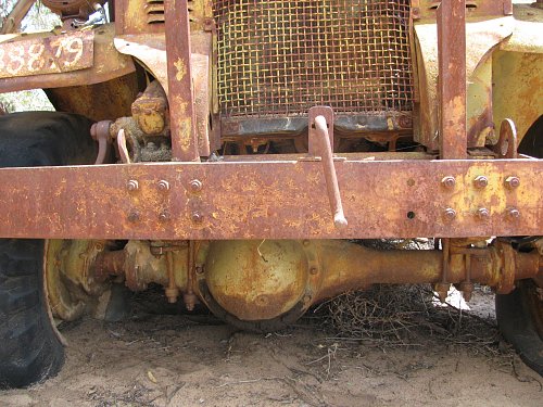

Where can I find that listing? Here is a photo of my 1940 Cab 11, F30S with Chev axles when I found it. Due to my ongoing ill health it is for sale if anyone wants one.
Regards Rick.

Old 07-06-17, 01:22
This one Bob?

Default Yep.....thank you.
Note...... I was under the impression that the response was from RichCam.
But do appreciate your response Rick.......just to many tricky Rickies around!!!!!!
...standard GM CMP front axle...... and no D rings as per early model!!!.....PS RichCam's Ford has at least "one" D-ring....!!!!!
