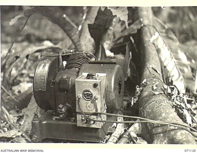

Nice close up picture of the CH1-395-4. This was the CND contract style. It featured the weather cover, which can be seen folded back.

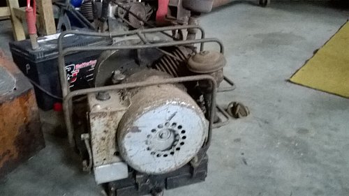

Look what I picked up last weekend, No compression and no spark but spins over on the push of a button.

The photos are a bit fuzzy as the conditions weren't too good for taking photos.

Good find Rick , it looks to be pretty complete . Many of them were converted to 24V operation to match the Larkspur radio system - these are usually painted in DBG
Bill Drew had a mountain of NOS spares for them . I still have a NOS crankshaft and valves, piston, rings and NOS brown coloured air cleaner with the yellow decal . Points, ig. coil and more. The original long flex exhaust pipe does turn up at swap meets .

Hard to see for sure, but in the first picture, is the kill switch in the "off" position?

I just noticed this detail tonight. Check out picture number 3 in post 1. That's a huge C broad arrow on the control panel.
