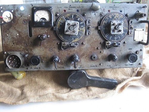

Hi All,
Recently I swapped some radio chassis for a 19 set,
Of course the Identity Plate is missing! (Scrap brass must have been worth a fortune, once)
The layout is different to my other sets

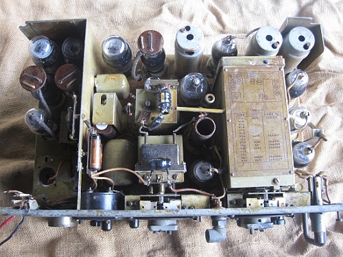

The only valves in it when I picked it up, were the big 807 and the little 6H6GT glass valve,
Unusual that they were left in it.
Also strange that the 6H6 is not a little metal unit.
The 807 is near the tuning condenser.
The wire to L3a has come adrift.
I have purchased all the other Valves from Joe Oost. (Thanks Joe)
They all light up, the filament circuit must be intact, this is a good start.
I have repaired the Square meter and it now works. (On 12 Volts range)

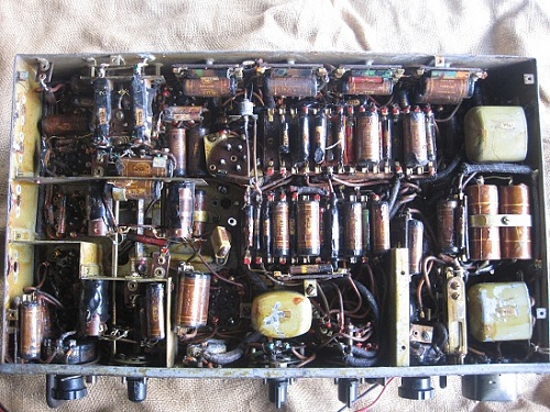

The valve arrangement in the B set and the IC are different to the other sets.
Underneath are tag strips everywhere, What a nightmare to wire in?
And a bigger nightmare to trace to the valve sockets, almost impossible I should think.
The plus side is the caps should be easy to change.
Maybe, As there is thick varnish sticking everything together!

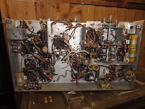

Quite obviously AWA Australian made by the look of the condensers and the rounded transformers.
The trimmer condensers have been pirated as well as the 6 pin power socket, shame actually, as the set otherwise appears unmolested.
Except there seems a-lot of space there on that side of the chasis.

Old 31-12-17, 10:49
Posts: 3,718
Hi Rod.
I think it is an Australian built Wireless Set No. 19 Mk II, but cannot offer you much more than that I’m afraid.
Quite an interesting layout. Perhaps adapted somewhat to suite available, local manufacturing resources?

I can offer some assistance.
I think I still have a photocopy of the manual but not sure. I had three of those AWA 19 sets in my collection.
These uncommon 19 sets were made during 1943 by the AWA works in Sydney. Those knobs are typical AWA type and were used on the 11 set as well.
The valve lineup, except for the 807, is different to the other ubiquitous 19 sets. AWA used the locally made AWV brand valves. 6U7G is one I recall ? They also changed the circuit around - they added a second audio amp and deleted a IF amp , or something like that.
Not an easy set to work on with many of the components hidden beneath other component boards. A real pain actually.
There was also a Aust. made power supply and all of the ancillaries, control boxes and the ATU.
When the WS19 group archive comes back up after the holidays there's a copy of the manual that can be requested from there:
Doc 1675 Wireless Set No.19 Mk II (Aust.)
Signal Training Volume III, Aust. Pamphlet No 15, Wireless Set No 19 Mk II (Aust.), 1943
It's more like the Canadian and US manuals (in that it's got the circuit diagrams, parts lists, and suchlike) rather than the British "just enough for the operator to use the set" Working Instructions pamphlet.
Chris. (G8KGS)

Thanks Fellas
Thanks Mike,
The control box on the jerrry can is yet another configeration
With the information I have found a manual
http://www.tuberadio.com/robinson/Ma...rovisional.pdf
This seems to be it alright. Mk2/2

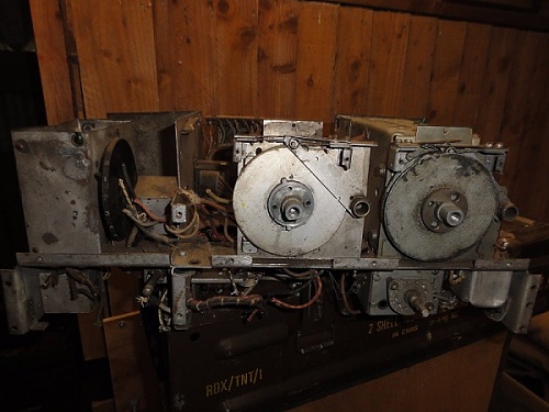

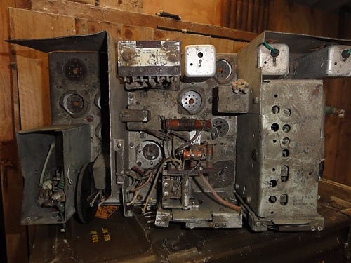

Name:	ws wrecked 1 re.jpg
Name:	ws 19 wrecked re.jpg
I'll have the B set tuner, thumb wheel and its box, Please
Name:	ws wrecked 2 re.jpg
Oh dear, Although it won't take long to trace out, Ha Ha there is not much left to trace
Anyone, Where to get those trimmers and rubber 5 pin plugs and sockets.
There was a rubber molder in town, I must see if he still there and if he could mold some
And then to find some 6 and 12 pin plugs and sockets that are not £45 each plus post!
cheers rod

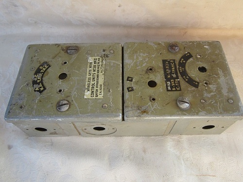

I have found the perfect control box for the wrecked 19 set
https://www.ebay.co.uk/itm/ww2-milit...EAAOSw9OFZMuZY
Post is a killer for an empty box
cheers rod

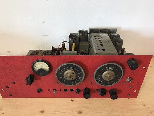

Here is another pretty 19 set for a project
Ebay UK https://www.ebay.com.au/itm/WIRELESS...97.m4902.l9144
A section receiver - appears fairly complete
cheers rod
