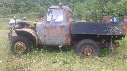

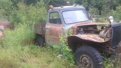

Greetings from Northern Ontario, this is my first post and the first I have ever come across what I think might be a 3/4 APT with a lot of modifications.
This journey started by looking for a truck to plow some snow and I have the good fortune to now own this one and another parts truck that still has its 3/4 APT dash tag, but they both need a ton of work.
I have owned a 51 M38 for 17 years, but never anything else military.

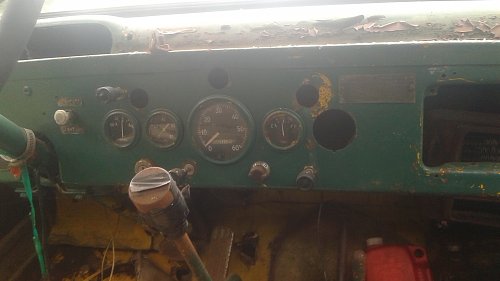

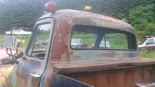

Truck one has what I presume to be a 54 Ford Cab grafted onto the original APT dash/cowl

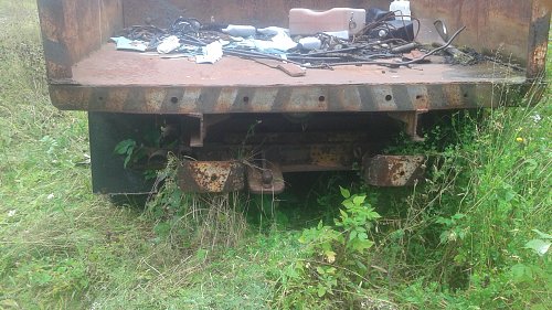

The data plate is missing and the frame has strange splices in it that look very neat..almost factory
Is that a factory frame shortening or something really well done back in the day?

This truck was the pride and joy of a fellow who is the grandfather of a friend of mine. I know it doesn't look like much but there is really some incredible detail in joining the cabs. This truck worked hard every day of its life I think, and it has plowed a lot of snow apparently.

Hello there. Interesting truck, someone did a lot of work to it.

Yes there is really an incredible amount of work put into this truck.

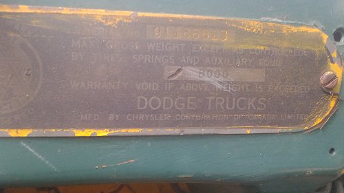

Ok here are some numbers
There is a tag by the passenger door mid way up from the floor that has the number #4230-2380 stamped in it.
The serial number in the cab on the Dodge data plate is a frightening 91166613, if you are superstitious that is :0
The engine numbers are T149E 13190

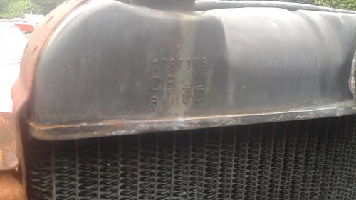

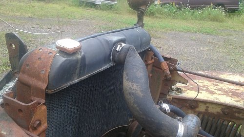

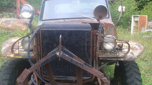

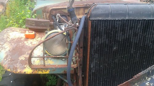

The rad appears to be a direct fit, but doesn't have the center fill at the top, rather off to the side.
It doesn't look hacked in at all, and appears to bolt right in to the factory location but the rad cover has been removed, though I did find it when scrounging around.
Part number on the Rad with the DPCD Logo on it
1787376
CD DP
B64 CD

the Cab you have appears to be Ford F-100 and someone may be able to use that, the serial # you have listed is APT for sure, you can also find the serial on the frame behind the front wheel ,pass side if I remember , engine should be T-236, are the braces from the cowl to the floor still there, if so they have a C broad arrow stamped on them , again APT clue, hope this helps,

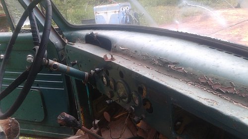

The cab is so carefully cut out to mate to the what I hoped was an APT tub...I am not sure it is easily separable. I haven't looked too close at the floor, but it looks to be a blend of both trucks. I believe the cab to be a 54 ford, and if you look close you can see where the gauge cluster for the ford leaves a space over the APT tub.

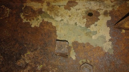

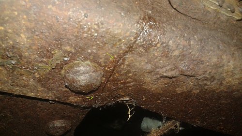

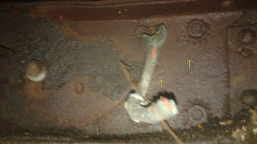

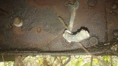

Are the frame splices factory?...The joint sure looks neat and tidy
Or were the APT short wheelbase on a factory one piece frame?
Name:	Frame seam 1.jpg
Inside of frame rail
Name:	frame seam 2.jpg
It is hard to see but there are little green arrows outlining the seam in the left bottom corner
Name:	frame seam 3.jpg
Bottom of frame rail
