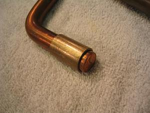

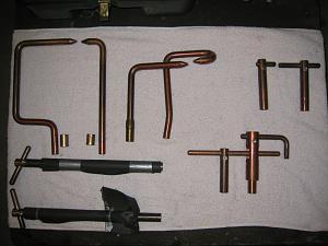

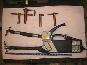

Default Measurements
Hi Bob
The tongs that go with the Quick Spot that I have measure .786 inch diameter or 19.96mm the others that I have made adapters for are .628 inch diameter or 15.87mm.
Name:	Spot Welder # 001.jpg
Name:	Spot Welder # 004.jpg
Name:	Spot Welder # 010.jpg
