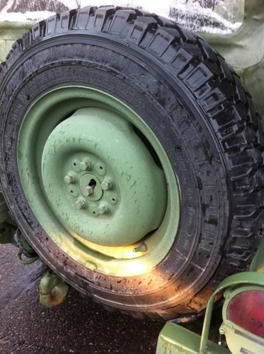

I have seen a few guys using the Michelin 4X4 O/R 6.50R16C. They look good on the vehicle and run a little smoother than the originals. I will be using these when my current tires are done.
ATTACH]79172[/ATTACH]

Here are a couple of more shots of the tires.

Very nice Dano.
I think i will get the same as yours.
Robert

The XCL was the second generation of tires for the Iltis. Is Michelin even making them in that size anymore?
Anyone with an Iltis that I know of has made the change over to a wrangler MT in the smaller sizes.

They were available two years ago. No reason to think they would be discontinued. They are a good tire.

It's no surprise to me but Rob was right. I got an email from Michelin today saying they have discontinued the XCL line. Guess you will have to give Goodyear a try.
