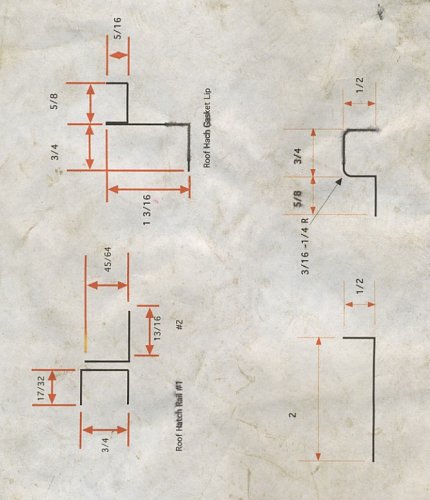

Hi Jordan
When I responded I had miss read your request thought you were looking for a length of gutter and sealer.
Just went out and measured both HUP and C60S Pat 13:
Gutter (C60S) 39 5/16 of an inch, extends from the front of the windshield post to 1/2" past the back edge of the door frame. The stops/sealer on both HUP or C60S is 36 3/4 inch long, it falls just a little short of both ends of the door opening.
Did find my old drawing of the sheet metal I had made up at one time as you can see from the condition of the drawing it was a few years ago.
