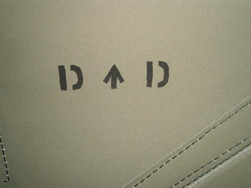

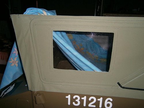

When doing the signage for my restoration truck I decided on using vinyl numbers for the doors and nose panel. I made this choice based on likelihood of me stuffing up sprayed stencils. The vinyl is neat and consistent in appearance, but does not have the same look as stencilling would. In fact, I think I will use stencils in future, now that I have had a little more experience in last couple of years. If you DO wish to use computer cut numbers/lettering, be aware that both white and black vinyl film are available in matt finish. I couldn't get that at the time I wanted to, so spent some time lightly sanding the vinyl before applying it to the vehicle. Not a fun job. Incidentally, the D ^ D marking on the side curtain curtain was done by stencil I hand made. Not very neat, but functional. Now that I have acquired a sign cutter, any future marking will be done as a stencil. Stencilling is easy if using the right materials. On canvas any vinyl film can be used to make the stencil, because it won't be difficult to remove the film from canvas, but I would be reluctant to use standard vinyls on paint. The solvents in paint may cause them to release from the surface OR the adhesive could seperate from the film, making a real mess on the paint surface. I have had this happen when applying the 9th Division marking on my green truck.

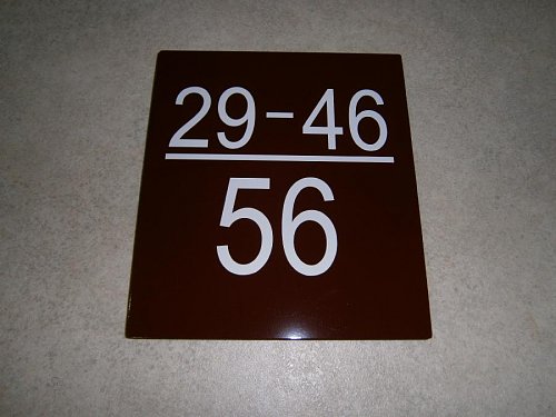

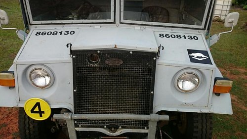

The numbers on my grey truck are also vinyl. I don't have any issue using this method on that truck, because it is not presented with the same desire for originality. It's my daily driver, (well, not literally) so gets knocked around a bit. The second photo above, shows the TAC sign for 29-46 Infantry Battalion. Vinyl film was used here also. I did ask the sign place who did the artwork for me if they had stencilling material, but they did not have any of that material. In fact they had didn't even know of a cuttable material for making stencils! I find that quite remarkable.

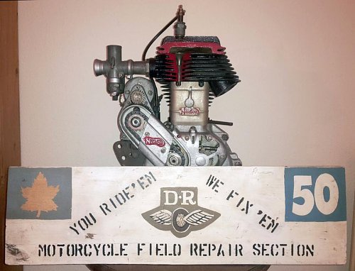

Well, I've been applying most markings etc. usually myself, and am not bad at it, as a lot of people aske me to their vehicles, problem usually is that it's too nice! during wartime conditions there were no perfect brushes and stencils with glue on the back etc. etc. so overspray, ragged edges etc. is all possible, even from the factory it was not always perfect, just study lots of wartime pictures, never copy someone elses restored vehicles, they may have gotten it wrong somewhere too.
Favourite method is also as described above, make something up in the PC, print it out, and cut out with sharp knife, then copy onto the part, I usually use lead pencils for that, the softer the better, it can be removed afterwards with soapy water, and that is what was used during wartime too, so most original, even if you later still see traces of it.....
Here a sign I just did a couple weeks ago for my Canadian field workshop display;
