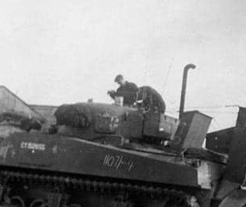

At the Sherman Minutia website can be found an image of Holy Roller taken in May of 1944. I've added a screenshot for discussion purposes:
http://the.shadock.free.fr/sherman_m...mbat/m4a2.html
Name:	Screenshot 2022-02-08 at 15-01-06 M4A2(75) in combat.jpg
Now an opinion on the tracks, they appear to be the rubber chevron type (T48). So given the date, it is quite likely these were the tracks it wore landing at Normandy?
regards,
Jack

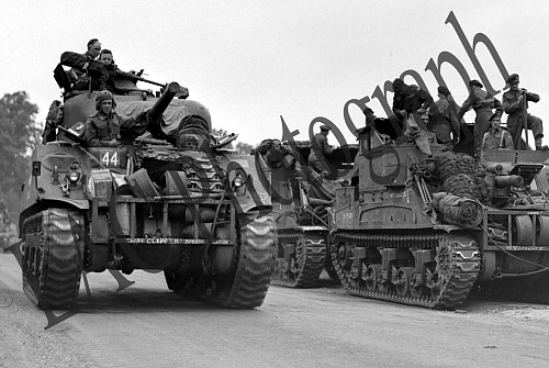

These Canadian RCA photographs were taken during the pre-D-Day move to the docks and show T48 tracks being used on both Sherman tanks and Priest SPs.

Hello Ed, thank you for posting that great photo, but I don't think either of these vehicles is showing the rubber chevron track (T48). China Clipper looks to have some curve to their shape, so likely the T54E2 'cuff design'. It is a bit tricky because the image is of moving tracks, and the resulting motion blur makes the tread pattern appear much thicker than actual. The Priest appears to have T54E1 track, a type seen often in the early NWE campaign.
Size:  13.3 KB Name:  t54e2[1].jpg
Size:  13.5 KB Name:  t54e1[1].jpg

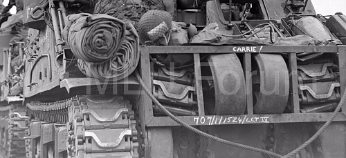

this may help your 105mm SP Priest (M7) track identification.

Hello Michael, thanks for the closeup of Carrie, it confirms what I had posted.
Look at the shape of the chevron cleat and notice a small tab maybe 2" long in the gap between the track pads. That is a characteristic identification element of the T54E1.

Been thinking over the chalked loading codes on the side of the hull, and have read over at the missinglynx forums, that each beach had it's own set of ships allocated for the landings. Those for Juno were numbered in the 1000's range, and as these assigned numbers were secretive, it would be odd to see them on tanks prior to the actual event. Also missing is the the unit's mobilization number. For the Hussars this would have been 3/1
regards,
