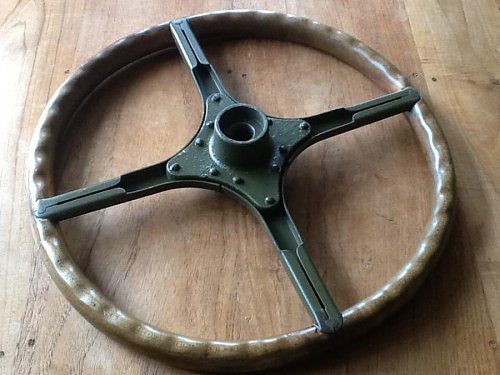

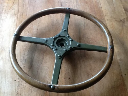

I think this has come up before, but can anyone tell me what the diameter is of the wooden Chevrolet steering wheel?
I'm asking because they are easily confused with GMC steering wheels - I know one is larger than the other, but which one?
This one's diameter is approx. 45 cm or 18 inches:

Default Just Measured My HUP 18"
Hi Hanno
Just walked out to the shop and measured the wooden steering wheel on my HUP built June 1945. It measures across the spokes to outside edge as being 18 inches.
Slightly larger diameter if you measure across the wheel between the spokes.

Thanks Phil,
Now we need someone to measure up a GMC steering wheel - I think those are slightly larger.

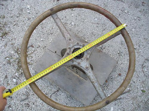

Meanwhile I found more info on the cckw.org forum including a CCKW steering wheel with tape measure and a link to a helpful French webpage: http://thierry.becker.free.fr/VolantsGMC.htm

The wheel pictured with the tape measure across it is a 4th type CCKW wheel which was used on late production vehicles.
As far as I know the only difference between this steering wheel and that used on the DUKW is the DUKW wheel has a pair of round headed nails driven into the rim not far apart to give the driver some indication of the straight ahead position when afloat.
Hell no! I'm not that old!
