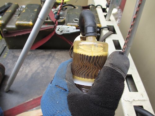

Default On the topic of fuel filters

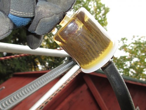

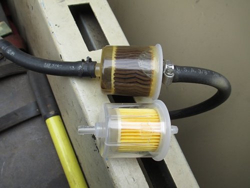

Hi All
Here are some photos of the inline filter on my Pat 12 C60L that started burping and farting recently when under full throttle on long up grades.
Name:	W Fuel Filter 2014 - 001.jpg
Name:	W Fuel Filter 2014 - 002.jpg
First two photos are with the regular fuel pump sucking fuel the last is with the electric fuel pump at the tank running note what happened to the length of the filter element.
Name:	W Fuel Filter 2014 - 006.jpg
Yes replacing the filter did solve the problem.

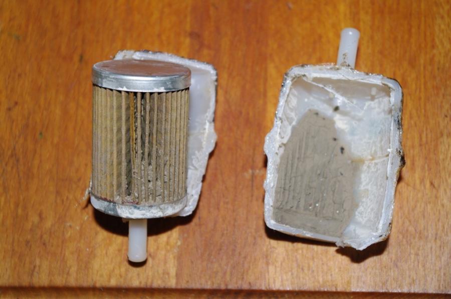

Hi everyone - removed the inline filter - it's black plastic so you couldn't see inside but when I removed it - oh brother... so no wonder it's been having difficulty. I performed an autopsy on the filter with a hacksaw - and wow.... So I'm going to go through the truck end to end. I replaced the filter and flexible lines - and the fuel coming through now seems pretty good - removed the oil bath filament and have cleaned it and will replace the oil - and have removed the plugs. They're a bit Keith Richard - old and coked up. So I'm now in the process of knocking over each possible problematic problem one after the other. New plugs, leads, coil, condenser and so forth. So - the truck has been an older restoration - and since I've had it it's been in storage pretty much - and it would run like a sewing machine when I give it a short run - but short runs aren't what it needs - and sitting around obviously hasn't been great but I'm determined now it'll be crackerjack.
blitz filter 1.jpg   blitz filter 2.jpg   blitz filter 3.jpg   blitz filter 5.jpg   blitz new filter.jpg
Well done Warren, it's always pleasing to prove the fault, esp. with tuning problems which can be tricky to isolate. Generally we simply replace everything without learning the precise cause.

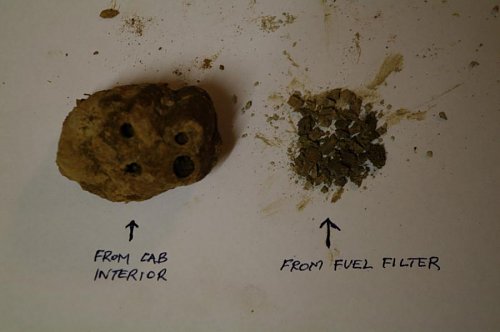

Just to expand on the diagnosis - I believe your CMP was suffering from Sceliphron caementarium - commonly known as the mud dauber wasp! It so happens my F15A suffered this particular ailment when it first hit the road. It drove perfectly well until I filled the fuel tank at the servo, which would have been the first time in many years, and must have dislodged a mud wasp's nest adhering to the upper tank area. After that it lost power up hills and could barely hold top gear on the flat. Like your truck Warren it was an older restoration which had been stored for many years, and since I lacked confidence in the restoration I fitted an inline filter initially, in case the tanks hadn't been cleaned out properly. As you can see the brand new filter was already badly clogged, which confirmed my fuel starvation diagnosis, and I was able to identify the culprit by comparison with a mud wasp's nest, of which there were many throughout the vehicle. Mine were built in Northern Victoria, whereas yours appears to be Riverina red variety!
Name:	TONY7272 - Copy.jpg
ID:	68606 Click image for larger version
Name:	TONY7278 - Copy.jpg

The upshot here is that by causing fuel starvation, our cheap plastic fuel filters alerted us to a potentially serious problem - Sceliphron caementarium! These critters are definitely bad news, and not just for CMPs. They've even brought down commercial airliners, by building mud nests in pitot tubes. In one case in 1996 the death toll was 189: "Investigators believe a colony of black and yellow mud daubers got into the tube and built their cylindrical nests inside, causing faulty air speed readings which were a large part of the crash. This species also brought down another plane in Washington during 1982."
Now that I've thoroughly cleaned out my tanks and lines I'm no longer running a fuel filter, but in light of these encounters with Sceliphron caementarium, it's even more imperative with fuel tanks of unknown condition. Rust flakes will merely cause fuel blockage, but any mud nests present could potentially ruin a motor, and we'd never even know how it happened!
On a proper resto of course I'd be using an original filter, however I'd probably use a paper element, because I believe they provide much finer particle filtration, by virtue of microscopic packed fibres. Certainly they're standard in critical applications like engine oil filtration. The downside of course is they're prone to clogging, as seen with these inline filters, including Phil's example. I suspect that would rule out paper as a fuel filter medium in WWII military application - even a large paper filter may clog quite rapidly on fuel poured from POL cans during a Libyan dust storm! The packed shim filter may reduce engine longevity in such conditions, but that's hardly a consideration in wartime, and certainly preferable to constant stoppage in convoy to replace clogged paper filters!

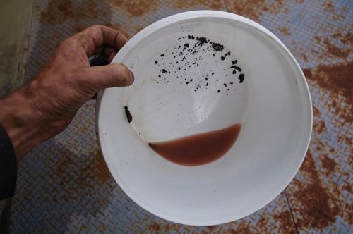

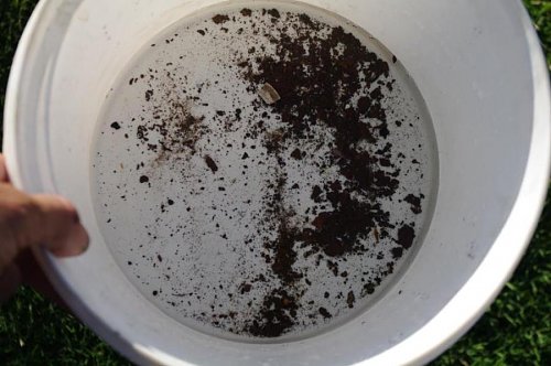

Well - drained the fuel tank and to my surprise, very little rubbish came out. About 60 litres of new petrol came out - I only filled it up the week before and in the first tranch of fuel removal only a miniscule bit of ...rust? Black grit? I was expecting shards of rust and detritus - but the fuel flowed freely and came out clean. There wasn't enough rubbish to photograph - but I'm not happy until I've really checked out whether there could be a wasps nest up inside. Certainly we get wasps nests around here - I have a brand new Davey Firefighter pump sitting in the shed - the dealer covered up the outlets/inlets with paper coffee cups and taped them up to stop wasps nests. I'm waiting now for the arrival of the new plugs, points, leads, dizzy cap, oil filter, rocker cover gasket (just in case) etc. See how we go...
