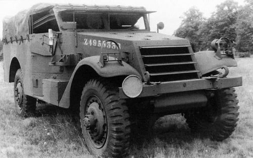

This, whilst a B/w pic, is UK and I think 1943.
The paint variation/camo scheme is visible, but by May 44, the only pics I can find are single colour - though in B/W this is obviously hard to confirm what... would be great to see these accurately colourised.
However, if they were repainted (same as Jeep in "mickey mouse") in 43, they would then have been repainted in 44.
If straight off the boat from USA, then obviously no point repainting... but Phantom had their WSC from late 43 into early 44 depending on the squadron... so it is likely that many were repainted before war mobilisation orders came through.
Tim
