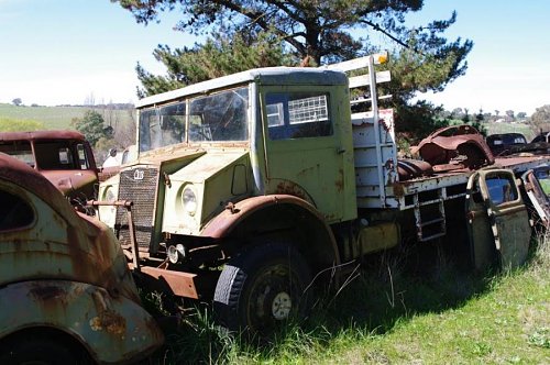

If I may stumble in here; I wonder if the rationale for CMP canvas doors is the same with my International K5, as pictured? I wonder if I'm safe to assume that it fell into the category of "15cwt and 3 ton WD vehicles when undergoing 4th Echelon repairs"? I know that in other areas of military history, one should never assume, and I guess the same is true with these vehicles?!
Mine also has a canvas roof, and I haven't been able to find any information about the use thereof.
Matt
1942 International K5 3-ton truck ARN 43362
1940 Holden-bodied Chevrolet staff-car
1941 Holden-bodied Chevrolet staff car
Old 17-03-14, 05:55
Default Canvas doors
Originally Posted by Matt Austin View Post
G'day folks,
If I may stumble in here; I wonder if the rationale for CMP canvas doors is the same with my International K5, as pictured? Mine also has a canvas roof, and I haven't been able to find any information about the use thereof.
Matt
They were a tropical mod so they could be removed for better ventilation so that wouldn't apply to the Inter. The canvas 'Sunshine' roof is also on many 15cwt CMPs, as Mike C has mentioned previously.
