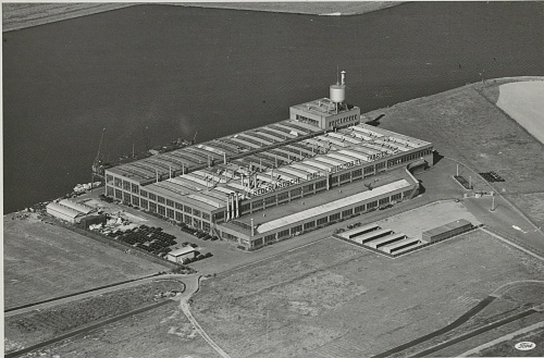

I am trying to find more information about the assembly of Ford CMP trucks at the Ford plant in Amsterdam, The Netherlands. Somewhere I read that shortly after WW2 an unknown number of new 3-tonners were assembled from crated trucks. These were supplied to help alleviate the problem of most if not all mechanical transport having been robbed by the German occupation army during the war.
Aerial photo of the Nederlandsche Ford Automobiel Fabriek at the Hemweg, Amsterdam, September 1949

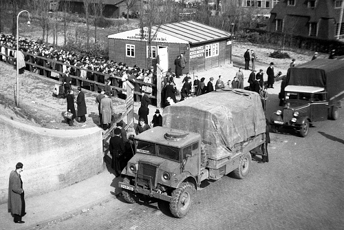

This F60L with civilian registration HZ-53678 may well have been one of the CMP trucks assembled in Amsterdam. It is a late version and other than being filthy, does not show signs of having seen military service. I miss the typical wear & tear and markings, for example.
It is pictured here in use with the Dutch Railways bus service in 1945. Yes, people were transported in the back just like soldiers were.

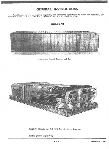

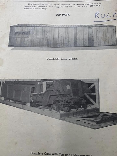

Indeed, as far as I understand Ford Amsterdam assembled new trucks straight from their shipping crates. I reckon they came from stocks in the UK because there were still vast amounts of uncrated vehicles present at facilities like Pearsons of Liverpool when the war ended. They must have used the unpacking & assembly instructions like the ones you shared on here (F60S for example)
I think these 3-ton GS truck came in Single Unit Packs (SUP), although at least C60Ls also came in Multi Unit Packs (MUP):
ID:	132830 Click image for larger version
