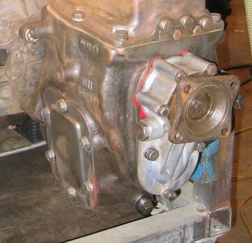

I went out and took some pictures of the part I am talking about.
Gary

Well I figured it out, Brute force and ignorance works everytime. I had to use a small sledgehammer but the cover finally came off. The great news is that all the gears and bearings look good, all I need to get is new seals and gaskets.
Gary

More pictures of the t-case.
