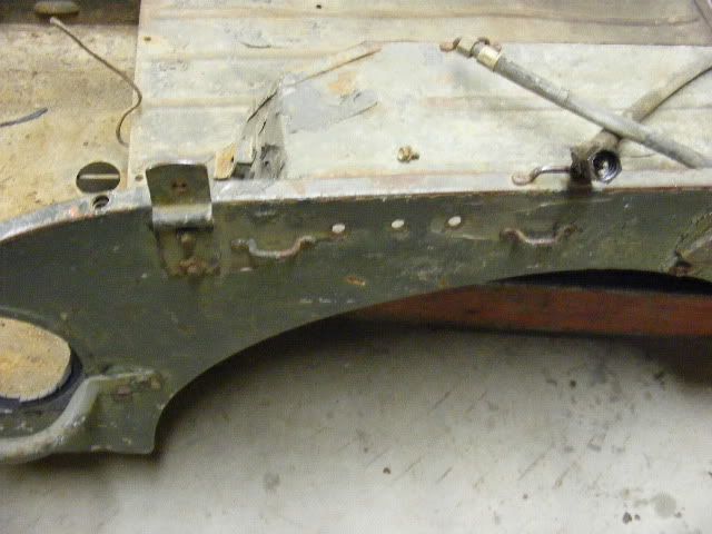

On the sides of the jeep there are three holes just behind the driver/co-driver. Anyone know what these were for?

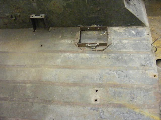

Lastly, there was this samall tray on the floor behind the driver. While it would appear to be about the size of the "case, spare valves" for a 19 set, the jeep does not have any of the usual holes in it to mount radios. The tops of the rear fenders are unmolested.
Any ideas what this jeep may have held for special equipment?

The holes in the tool box is for a heater, the 3 holes on the sides are for the winter hard top, the guess on about the cowl the spare tire carrier is correct. the last bracket could be a place for spare vacuum tubes kit for a 19 set maybe. That's my 2 cents and a guess.

I have an M38 with some of the same holes and mods as yours. It did not have the #19 set spares bracket, but has a bracket on inner body passenger side that was to hold a wireless related cable. Brian Asbury told us that the holes in the body meant the vehicle probably had a winter top and the tool box mods were for a gasoline fired cabin heater. Mine has the same cowling holes and they do appear too be in the shape of the spare tire carrier for the Recoiless Rifle, but no other holes in the body seem too indicate it was a RR jeep.

Thanks guys, those are the answers I was kind of suspecting. I am still not so sure about that bracket on the floor. There are no holes to suggest radio trays or antenna mounts.

an ambulance jeep. The grilles are for the hot water heater and the three holes are where the front of the ambulance rack mounts.
