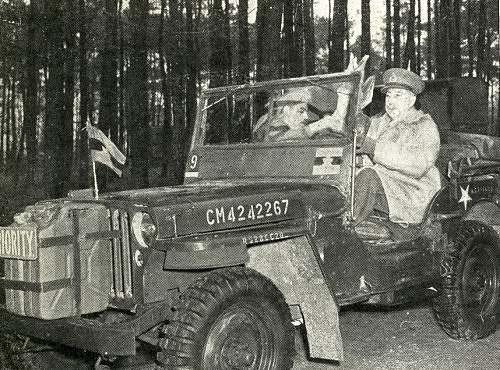

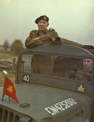

Looking at the markings of jeep photos concerning Crerar, I observe two distinctly different heights (and widths) when comparing the unit and formation markings.
I'll see what I can do to incorporate the 5x7 measurement - it certainly will be imperative for the rear since the surface area is so restrictive. Still though, I don't see the AoS number fitting within the 5x7 as it would drastically change the official proportions - unless there is a typo in the diagram and should read 7x5? Also, if the number is suppose to be 5 3/4 tall, that certainly won't work in the horizontal format.

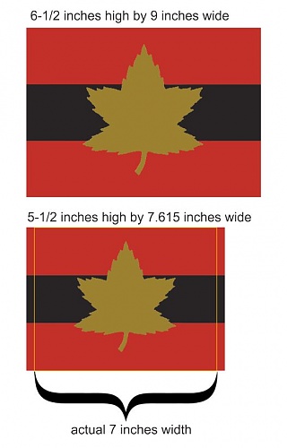

My purpose for initiating this thread is to create the artwork that will be printed out for a 1/35 scale jeep I've planned to build as operated by Crerar in Normandy. As can be seen, there are two different War Department/Census Numbers.
The diagram that was linked by Eric, appeared as appendix "C" section of the 4th Cdn Armd Div. around February 1943. I've no doubt of it's authenticity, but for me, I'm seeing something different in the 1944 photos.
Name:	formation study.jpg
The formation marking actually scales down quite nicely, just need to trim off a bit of the sides if wanting to conform to the 7 x 5.5 inches. I think I understand though, why the rounding down to 7 inches, as the scaling of the width results in quite a bizarre fraction.
The unit sign is much more problematic when going by the diagram measurements, as it would have you fit an almost square design into a horizontal format. Rereading Eric's post, I noticed he has switched the values around, 7 inches being the height for the AoS marking. Now this is doable, but is pushing the limit of the surface area on the front windshield. Obviously the 2" white bar will have to located within the 7 inch height.

The modified windshield in post #5 (on jeep CM 4232012) appears to have a shorter lower panel: it may well be an early 21” tall slat grill windshield frame that has been modified with the arched extension. The overall height of the standardized windshield frame is 23”.

Brian, Re the short screen, the front bumper also appears to have a curved end. Accident damage or a mod. as well?

Can anyone read what is stencilled across the top centre of the front fender? It might also be repeated over the rear wheel well but is a lot longer in both cases than the usual ‘TP XX”.
