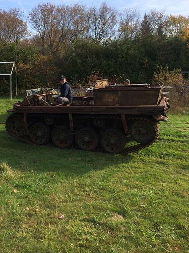

Had the opportunity to participate in a very well managed MV recovery. The vehicle was a cut down FV402 Armoured Observation Post. The new owner is Jonathan Bradshaw. From what I can gather this was an unsuccessful trials vehicle based on the Cambridge carrier.
Mike and his FV432 made short work by dragging out the carrier and with a good steel sling and sheaves the carrier was pulled onto the trailer.

Where was this recovered from?

Should have included that in my thread. The FV402 came from Mike Calnan’s ‘Sword and Ploughshares’ museum near Kar, ON.
