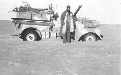

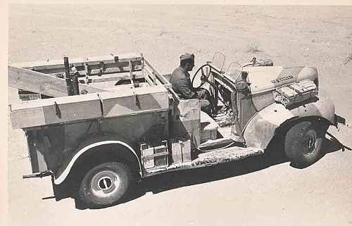

Has anyone investigated the beds on the early lrdg Ford 15cwt pilot cars? I can not see the side panel lines of a 1940 Ford pickup. All photos are poor, but I’m wondering now if the entire box was made up.

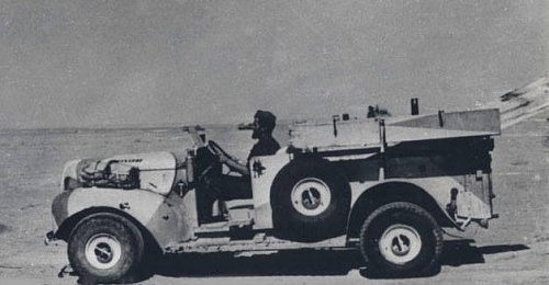

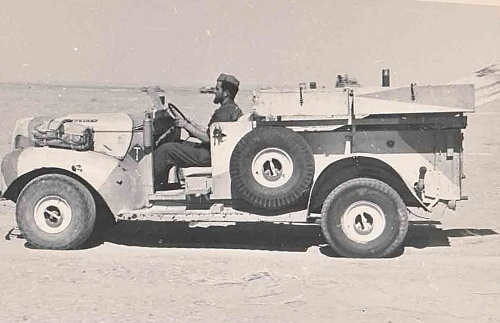

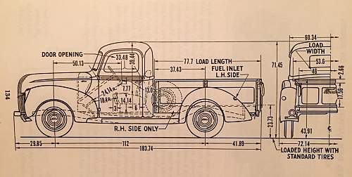

Interesting question. I always thought this was a commercial pick-up bed, altered for use by the LRDG by adding the boxes etc.
Maybe it isn't a US market bed, but a type of bed built locally for the local civilian market? It doesn't have any hallmarks of being a military bed originally.
ID:	130707 Click image for larger version
ID:	130708 Click image for larger version
Name:	wd_LRDG_Ford 01 V8_07.jpg

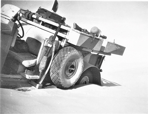

I am drawing out this nonstandard bed which seems to have elements of a British trailer. I am confused about the 2”x4” looking things which are on all for corners of the bed. I think they are in fact short pieces of 2x4’s slide in a bracket with a bottom stop. Longer boards could be used for a canopy. They may also help keep the sand channels from rubbing against the truck. I could use anyone’s opinion on what these are as i am guessing
Old 09-12-22, 04:44
Default Are my eyes that bad......
Hi Scott........ what 2x4?????
I can see the sand channels being used judiciously.....I enlarged the pics but could not see anything that looks vaguely 2x4 in.
Civilians Cargo boxes of that period were pretty well all built of 18 gauge steel with floors one gauge more......military boxes of the 40's were 16 g. sides 12G. floor.....some tailgate and side drop panels 14 G.....but then everything military was overdone...... if the Ford Ute was cobbled together by local Cairo boys..... very familiar with more weight in the deserts is more gas and more diggin' out..... they would have opted for the light stuff and save weight for ammo and water..... Any other photos to look at....
