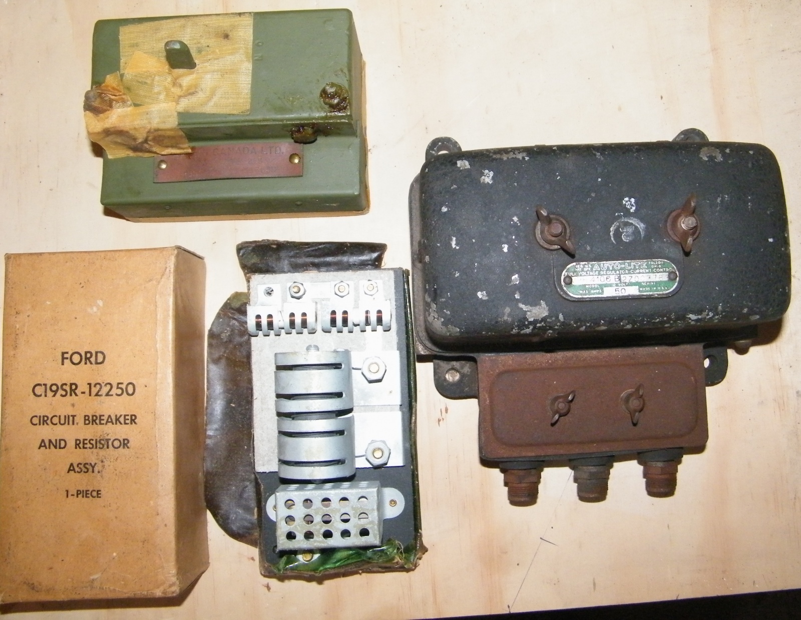

Default Lynx Electrical Components
I was just playing around with a couple of these electrical components today.
At the top of the picture is a nice NOS master battery switch , made by Bepco Canada Ltd. , then we have the voltage divider that mounts on the inside of the engine compartment against the firewall, this splits 12volt to six volt for the gauges. The Lynx uses 2 x 6 volt batteries to make the 12volts. The last item is the Autolite regulator , model number VRH 4106B , this is 12 volt @ 50amps rated, Cheers from The Tank Factory.
