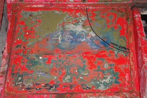

Thanks for that info. I gave that cowl to a mate so I will ask him if he could kindly rub it back below the 45988 to verify. It was beyond hope of restoration and I was running out of space here in the burbs anyway.
It came off an F15-A truck with ARN 55166 based on the transmission s/n. I thought the cowl may have been swapped from another truck thinking the unit number was the ARN, but perhaps the ARN 55166 is under the red paint higher up? More sanding please mate!
I rescanned the cowl 53166 photo negative with my new scanner at a higher resolution. Not much extra detail however came to hand. At least playing with various photo enhancement settings helped to make the details on the image more visible. Most of the numbers and bridge disk were almost invisible on the printed photo.

The ARN may be above or below, ie along the top edge or the bottom edge of the panel, with the Unit Embarkation Sign bars of colour most likely below the USN. The bars may be either vertical or horizontal - most likely horizontal, with the top and bottom bars being the same colour representing the second last digit of the USN.
Be interested to see what your mate turns up when he rubs the panel back.
Hi Mike,
The abovementioned mate is me. It's been a while since we conversed, I trust you're well these days. Jacques mentioned this thread to me and I was interested to read your information concerning the 45988 marking, which previously had me puzzled, as I was unfamiliar with the USN marking system. Further rubbing back revealed the coloured bars on the opposite side, which measure approx 8" x 1 1/2" with approx 3/4" separation. They've been obliterated prior to repaint but the edges are still quite discernible. Also visible on that side is some remnant numbering, presumably shipping information. The USN itself has been applied on a patch of Dark Blue applied over Light Tone disruptive colour to provide sufficient background contrast. Strangely there's no sign of the ARN having been applied. Remnant black paint may indicate TAC sign but there's no evidence of formation sign having been applied.
Regarding the colour code, it's my understanding the digit 8 is indicated by Service Colour in the British system, which I imagine could be either KG3 or SCC2 Brown depending on the period. Australian Army Service Colour was KG3 but in late '43 the colour Medium Green was officially approved as an alternative basic colour: "Khaki Green No 3 or Vehicle Medium Green is now the basic colour for all vehicles." This would lead me to conclude the coloured bars seen here are Medium Green denoting 88. I'll be interested to hear your thoughts.
Cheers, Tony

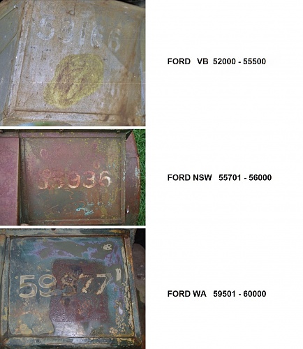

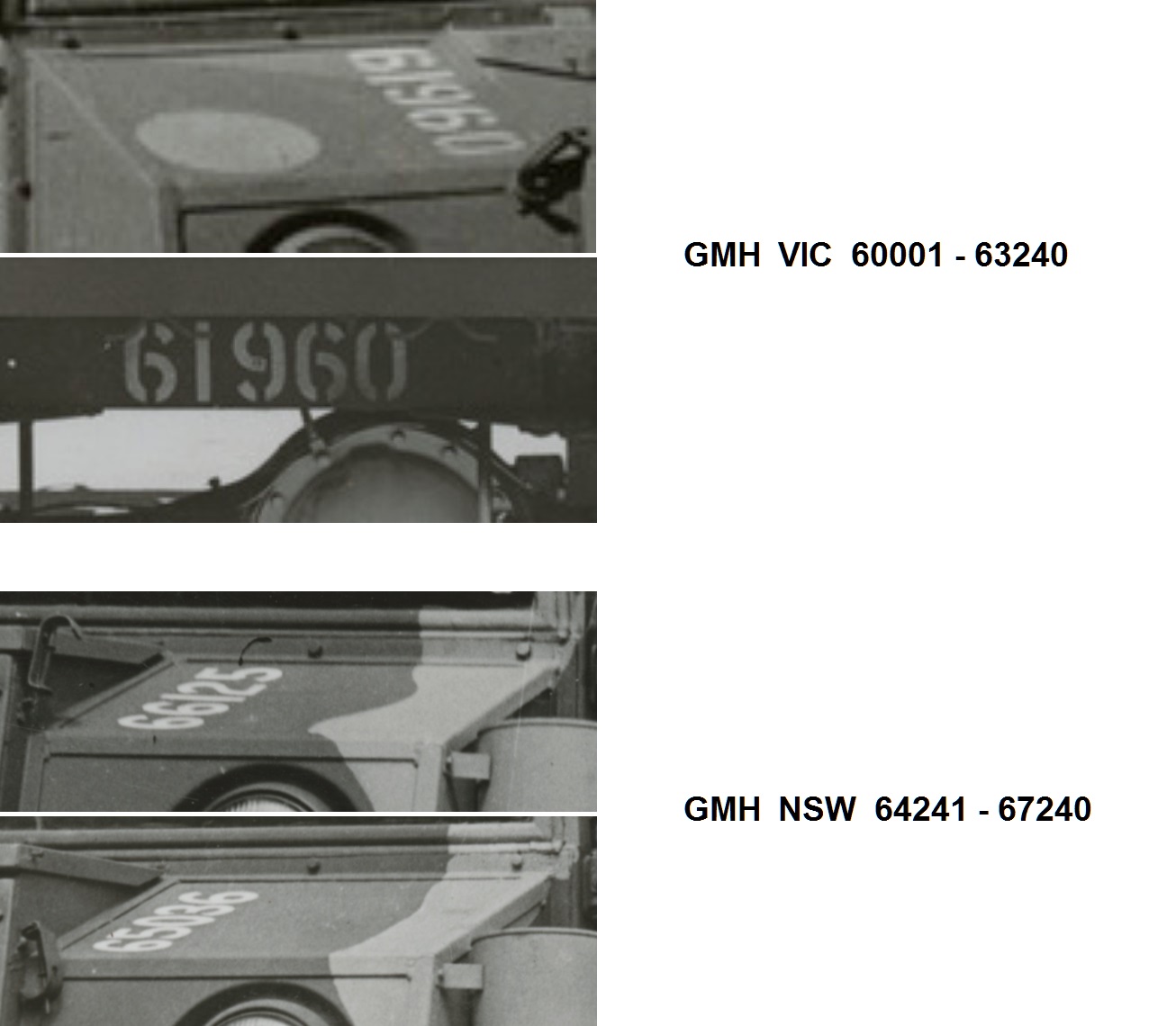

Regarding ARN font question raised by Jacques: The ARN font, and the position of the ARN on the front shell panel, varied between production plants according to local practice. The plant can usually be determined from the ARN record, which gives the State or Military District where the vehicle was first issued. Unfortunately it's often given as 'VB' for Victoria Barracks, which is rather confusing because there are Victoria Barracks in Melbourne, Sydney and Brisbane. It's a particular problem in the 52xxx - 555xx range, which is what we're dealing with in this case. Perhaps Mike can shed some light on this question.
Comparing VB ARN 53166 to NSW ARN 55936: the 3, 5, 6 digits look virtually identical to me, possibly reflecting an individual Ticketwriter's 'signature' as described by Tony. The WA ARN 59877 looks like a different 'signature' to me, ie. fatter and flatter, with a pointed upswept tail on the 9 digit. Two of these ARNs are centrally placed, leaving insufficient room for the Formation sign and TAC sign if required.
Name:	Ford ARN font.jpg

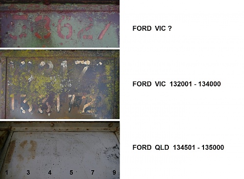

Other States including VIC and QLD used stencils, and placed the ARN along the top of the panel, leaving plenty of room for the Formation sign. However these stencilled digits were quite large and well spaced, which meant 6-digit ARN barely fitted across Cab 13 panel, unless it contained another '1' digit. This seems to have led to diagonal placement occasionally - Keith's gun tractor ARN 134855 may be an example of this practice. Postwar stencils were somewhat narrower, perhaps deliberately so for this reason.
Name:	Ford ARN font (2).jpg
Interestingly, just like Ford practice, Chev ARNs were stencilled in VIC but handwritten in NSW. In both plants however the placement was along the inner side of the panel.
Name:	Chev ARN font.jpeg
These are just my own observations over time, not based on any proper study of the matter. In the interests of authenticity it would be worth conducting an investigation of ARN fonts and placement on CMPs, perhaps using this thread commenced by Jacques to post examples and discuss.

Hi Keith,
That photo is at GMH Pagewood NSW, where for some reason a ticket writer was employed instead of stencils used at other GMH plants. Note the sideways ARN, also unique to GMH Pagewood. This practice continued through 71xxx range as seen below, and presumably into 6-digit range, although I don't have any 6-digit examples to confirm. Interestingly this C60L has the USN 49463 visible on the bumper, something I hadn't recognized until Mike's info on USNs in this thread.
132141 font is the standard stencil used by Ford VIC throughout the war. It can be seen in both 5-digit and 6-digit ARN ranges. Evidently Ford QLD used the same stencil, as seen on my F60L ARN 134579. This is the font we need for our No.9 FGTs. I have several examples from which I'll make tracings in due course. However I may not have all 10 digits. I wonder if anyone else has reproduced this font previously...?

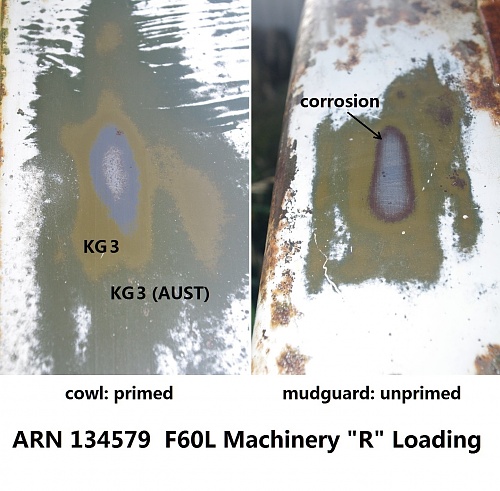

At your suggestion I sanded a section of its mudguard and can see at least 3 different colours applied to it so perhaps it was removed and not reapplied at one of these times.
It looks like Canadian KG3 (originally covered over at the wheel arch), then Australian KG3 (darker) then a much darker (Olive Drab?) New Guinea service?
I am 99.9% convinced the cowl is original and not a swap from another vehicle. As 55166 was an ex Bush Fire Brigade truck it would have been better taken care of than a lot of other vehicles that were sold after the war.

It's very difficult to remove the ARN completely without disturbing underlying paintwork, particularly Light Tone disruptive coat applied in production, which is extremely thin and easily rubbed through. I've found no such evidence of ARN removal on this cowl, which leads me to wonder if it was ever applied in the first place. You'll see what I mean when you inspect for yourself.
Name:	ARN 55166  camo pattern.jpg
Name:	ARN 55166 paint history.jpg
Unfortunately the mudguards suffer corrosion due to lack of primer, which attacks the paintwork from underneath and eventually bubbles through. This makes it difficult to ascertain paint history. It's possible to get results but you need the right technique. If you bring the mudguard up I can demonstrate. There should be only two colours under the red paint: KG3 applied in Canadian production, which remained in the 2-tone factory camo scheme, but was overpainted with something darker in service - probably US OD applied in NG Force service, although other possibilites exist, e.g. Vehicle Dark Green or Australian KG3.
Thankfully the cowl received primer in Canadian production, which helps immensely to preserve paint history, by providing a barrier to moisture reaching the metal. You can see the difference here, with a ring of corrosion instead of primer!
Name:	ARN 134579 paint history.jpeg
