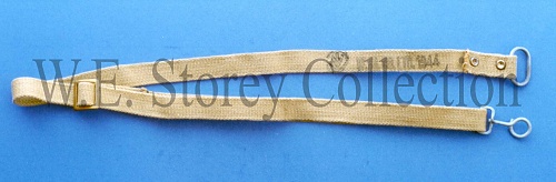

I believe that they WERE Sten slings, but at some point have been shortened. One give-away is the lack of any manufacture's stamp or date which was on the piece which has been chopped off. I am hopeful that I will stumble upon an Ordnance Instruction to shorten Sten slings for some other purpose.
Of course the Vocabulary of Ordnance Stores could also reveal if there was more than one Mark or Pattern of Sten Sling.
ED

You guys were fast on posting the Sten sling information; while digging about I found this reference to the Mk II (113) and Mk III (114) Sten Slings on page 9 in my copy of CW-2 Canadian Ordnance Catalogue - Parts Identification List - Carbine, Machine, Sten, 9mm, Cdn Mk 2-1 - 1953.
Attachment 120946
Rob,
This was from the Parts Identification List for the Sten Cdn Mk 2-1 and it only shows the Mk II and Mk III Sling.
ED

Colin, what Sten sling quantities were quoted in the documents? The question I have is why do these shortened 'slings' lack a manufacturer/date stamp; as was this stamp not added at the end of the production process? I cannot think of many pieces which only have a 'C Broad Arrow' and as it is, these were parts for other major assemblies.
ED
Attachment 120928
One has to wonder why they would alter the end that was already riveted. Why not just cut off the adjustable end and rivet it there? It doesn't make sense at this point.
I know, it is very strange. This thread has mapped out to some degree the various slings associated with the Sten Machine Carbine using primary source documents. We all know what a Rifle Sling is and we have seen a couple of photographs of the Mk II, or 2 depending on when it was catalogued; but who has ever seen a Mk III sling? And what about the BE 8574 sling, is this the item we have all been discussing?
I have one of these weird slings in my collection that I have held onto just in case I see of photo of one in use or find a document identifying it.
