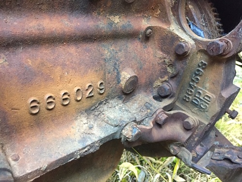

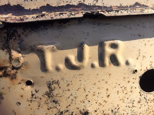

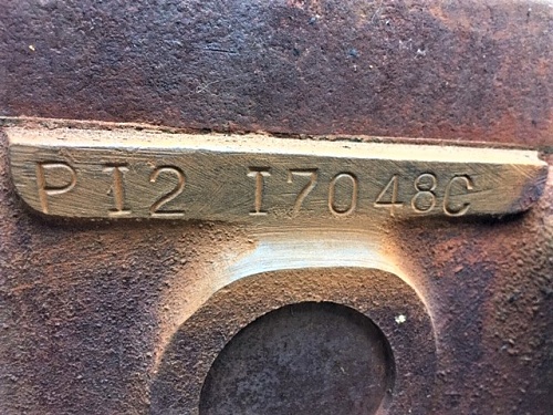

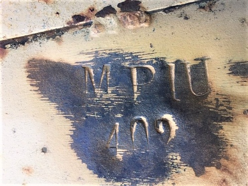

Had a look around - found engine number and a couple on the body. Whereabouts should I be looking for chassis number? And what's that group of four letters stand for (DPGD?) is also on inlet manifold.

Old 24-08-22, 12:56
Posts: 6,036
Default Nice
I remember the long block Canadian engine in these as having a bore of 3 and 3/8" and a 4 and 1/16" stroke. The T212 I believe used the same engine as did a few other Canadian sourced Chrysler light trucks . My 1946 T116 Dodge ute had the same 218ci engine.
Used to be one of those Plymouth army utes in the Bathurst NSW wreckers but that was so long ago I doubt either the wreckers or the ute still exist.
There was also a Dodge version of the 12cwt army ute but as I have written many times they are actually all 1941 Plymouths with some 'badge engineering' The trim and grills were altered in order to to make them look like a DeSoto or a Dodge which they are not.
Apart from myself, another VMVC member had two of these utes one of which was a DeSoto , they ended up in Sydney in the hands of Bob K. and I believe they later went to the Hughes collection .
The DPCD logo is seen on Chrysler parts , stuff like the bolt heads and other bits. At a guess it is: Dodge Plymouth Chrysler Desoto ?
The registered example I bought, the chap told me he towed a caravan up to Mildura for many years with the ute. He worked at CIG at Preston and he drove it to work well into the early 1980s - he said he bought it in 1956 at a Govt. surplus auction . It was finished in a red/black livery at one time, I would say likely used by the PMG after the war.
I think I still have the negatives, I took lots of pics of the Marong example which was a DeSoto. The original wiring looms were still intact , the glass instrument panel cover was unique to each version, the DeSoto had a fancy family crest , probably from the Spanish conquistador .
Old 24-08-22, 13:21
I agree with Mike about the DCPD.
A Chysler engine is prefixed by a C
A Dodge engine with a D
A Plymouth engine with a P
and a De Soto engine is prefixed by an S
A P11 engine and a P12 engine are both 1941 engines. Just early and late. Both are 3 1/8 bore by 4 3/8 stroke.
Old 24-08-22, 13:43
Default T.J. Richards
T.J.R. stands for T.J. Richards, apparently of Keswick, Adelaide. T.J.R. built the cab and rear deck.
Source: http://www.mapleleafup.net/forums/sh...779#post106779

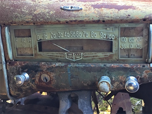

Thankyou all for your input: much appreciated! and yes indeed Mike - dash glass is a work of art: gauges should come up alright...

Engine Number P12-17048C was fitted to De Soto "Van, 12cwt, GS" with the chassis number 9829683, and was issued with the ARN 88652. It is recorded as a 1941 SP11 model.
It was disposed of to the Canada Cycle and Motor Co, but no date is given when this happened.
While it is not the highest engine number or chassis number recorded for a De Soto or Plymouth, it is the last or highest ARN registered for a De Soto.
