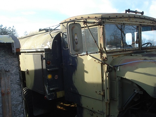

Can anyone give me the fuel tank capacity of the CDN version of the M217 (fuel tanker). I cannot find any details on line or in my collection of books. Note this is a different style than the US version M217. The truck cab data plates say M211 not 217. All help appreciated.

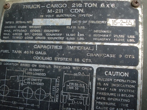

It is nice to see that a comparatively rare vehicle is being preserved, the tank capacity was 1000 gallons. Would it be possible to have a photograph of the data plate?

Thanks for your input, I will try to post a few more pictures when it warms up a bit..couple of days I hope. The last owner told me this vehicle originated from Camp Borden where it was used to fuel up helicopters. I have no idea if that is correct but thats what I was told.

Yes, the M217CDN was used to refuel helicopters.

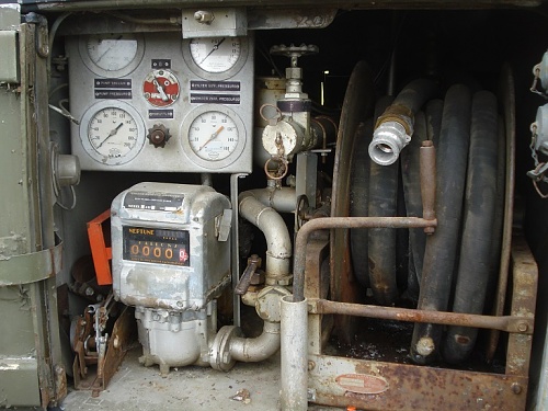

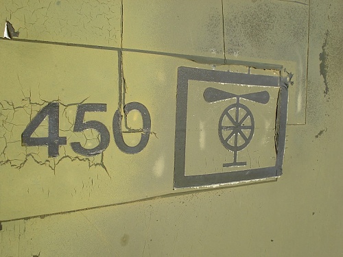

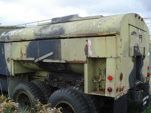

Follow up pics..anybody recognize the propeller insignia?

That looks like a truck I saw in a yard in the vicinity of Orangeville several years ago. I'm pretty sure the truck was used by 450 Sqn to refuel their Chinook helicopters in the field.
Attachment 117711
That is easy:
450
Tactical
Helicopter
Squadron (the two flaked off little pips on the top of the rectangle)
450 was in St Hubert then disbanded, and reestablished with Chinooks in Petawawa. If my Goofle skills are up to speed, they were flying Kiowas and Twin Hueys. https://en.wikipedia.org/wiki/450_Ta...opter_Squadron
Sometime used a bit of artistic licence with a wheel and staff to depict the echelon tail. Off road mobility required to top up tactical helos, but not crazy cross country mobility.

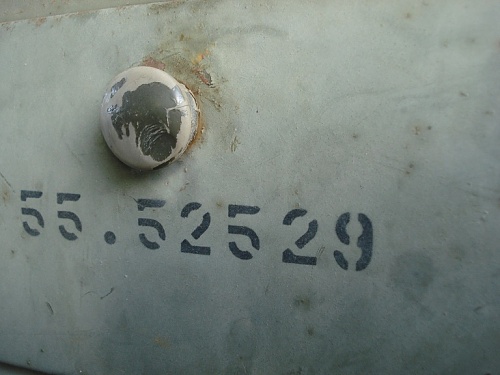

Nice catch! 55-52529 is the earliest of the M217CDN Fuel Servicing trucks and was used by 450 Squadron to refuel Chinook Helicopters in Ottawa. The propeller insignia is the NATO tactical symbol for tactical heavy lift logistics helicopter squadron.
According to C-30-248-000/MA-000 Canadian Army EME Manual, Truck, Tank, Fuel Servicing, 2½ ton, 6x6, 1,000 Gallon Gasoline, w/Segregator, Data Summary, 20 November, 1967 the chassis for these specialized vehicles was the M207CDN but I am not surprised to see that a M211CDN was used instead.

There is history that I think is being missed. Although 450 Sqn did spend a couple of years at St Hubert, they quickly moved to CFB Uplands to fly the first incarnation of RCAF Chinooks, in the 70s, 80s and 90s until the government morphed a historic base (started in time to take part in the WWII BCATP) into CFSU (O) and disbanded the Sqn (which was reformed when the government once again acquired Chinooks).
I have no proof that it is so, but is it possible that the tank body was salvaged and transferred from a worn or damaged M207 chassis to a M211 chassis that happened to be available?

My records show that while the official documentation states that specialist bodies such as the M217CDN and Fire Fighting Trucks where to be mounted on the M207CDN Chassis that in practice the M211CDN was used instead. The numbers of vehicles tends to indicate that pinning down the exact reason why M211CDNs were used over M207CDNs is more an exercise in 'picking the fly s__t out of the pepper' by enthusiast hobbyists and that it is most likely just a case of using excess M211CDNs.
