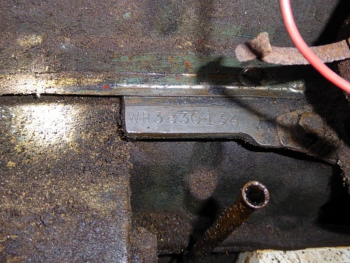

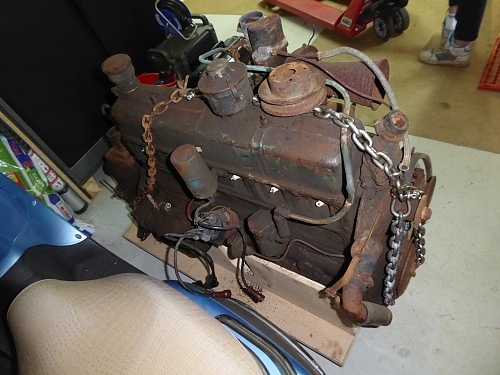

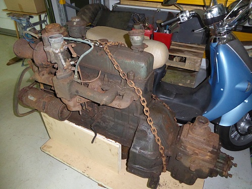

Please ID this Chevrolet engine. As far as I know it is a 216 cid engine which was taken out of a CMP truck in Belgium many years ago. Last ran when taken out.
Serial number is WR 3830134.

The casting number behind the starter is the key to these motors. This list is pretty good for checking what you have. Looks like a standard 216 to me.
http://www.1954advance-design.com/St...g-numbers.html
