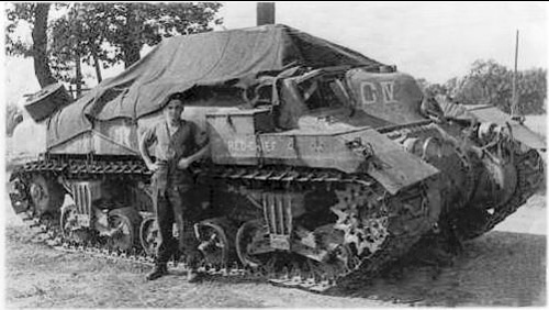

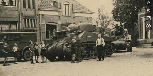

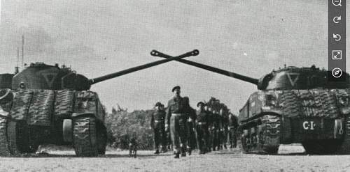

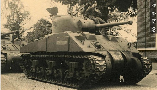

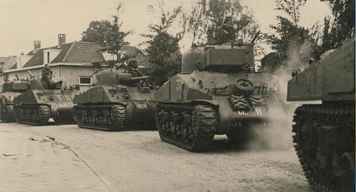

What exactly do these markings represent? Were they tactical, or specifically applied to those vehicles handed over to the Dutch at war's end?

Hello Jack,
Good question, I posed a similar one but cannot find it back.
I do recall Mark Tonner saying these were classification codes denoting the condition of the vehicle. If I recall correctly, C-I denotes it is in ready to use condition, in need of daily maintenance by the crew only. C-IV is the other end of the scale and it denotes the vehicle is severely worn out and needs to be rebuilt at depot level or struck off charge.
As war in NW Europe was coming to an end, the Canadian Army started "vetting" their equipment for further use in the Pacific and/or disposal after the hostilities ended.
Ah yes, it was on FB. I quote it here for future reference:
C IV… what does it mean?
As recently as yesterday, we’ve been asked what this mysterious marking as found on the Kangaroo APCs at the end of the war means? To tell the truth, it wasn’t until about two and half years ago that our own Mark Tonner cracked the code.
This marking only appears on the Kangaroo hulls in photos taken in June 1945, just before the Armoured Carriers were taken away to Ordnance depots and the Regiment disbanded. The stencil/marking is not mentioned in either the war diaries of the Regiment or the attached RCEME unit (123 LAD). We had always surmised that it was some sort of Transport of Field Park inventory code. The same marking was applied to fronts of ALL the Kangaroos.
Turns out it is a ‘classification’ code for demobilized vehicles, and there are six different classes. In March 2018, Mark Tonner came across the Library and Archives document that explained it all.
Sadly it was not good news. Apparently ‘C IV’ isn’t a very good grade.

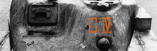

Detail of the front of 'FAME' (CT160098) from June of 1945. The 'C IV' classification mark has been highlighted in orange.
'C IV' is an ordnance classification denoting that this vehicle needs significant repairs to bring it up to a fit for continued service standard.
The Ram Kangaroos by June of 1945 had travelled hundreds of miles on their own tracks and experienced dozens of enemy engagements. Most of the Rams had already had significant repairs and extensive parts replacements done by Army Workshops and the unit's L.A.D.
Regardless of this care, they were pretty tired vehicles by war's end.

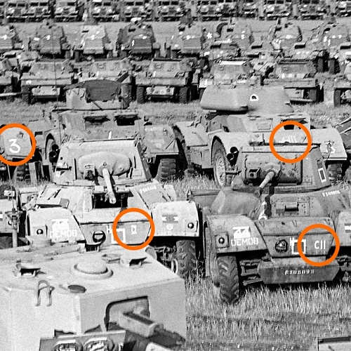

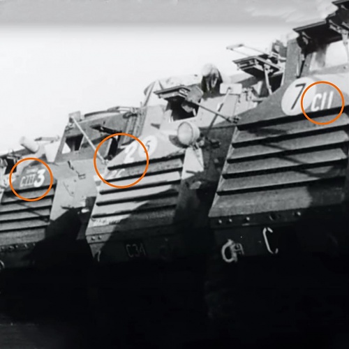

Annotated screenshot from the Canadian Army newsreel #105 showing the Demobilized Vehicle Park outside of Amsterdam. here, some Light Armoured Cars have been classified C-II and C-III...
Detail of a Dutch Archive image (Spaarnestad Foto) showing Ordnance Dump Deelen in June of 1946.
Heavy Armoured Cars, Humbers and Staghounds, classed as C-II and C-III...

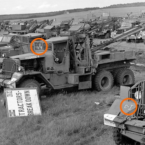

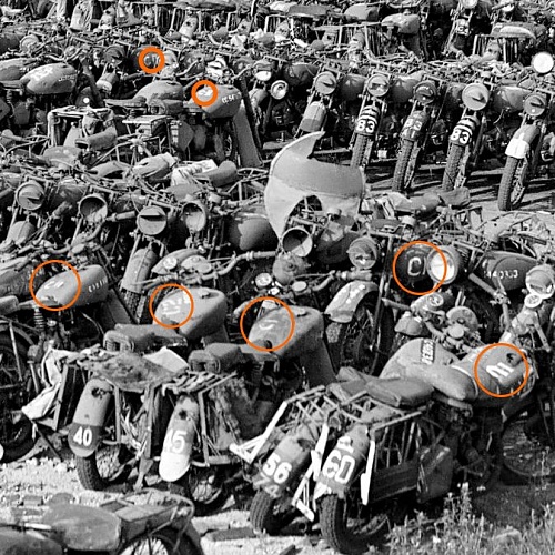

RCEME Breakdowns, one is a sorry state C-IV, another a ready-to-go C-I...
'B' Vehicles, the softskinned ones like Jeeps, Trucks and motorcycles were also given similar classification.

Those were posted by another gentleman on a current discussion over at missinlynx:
https://www.tapatalk.com/groups/miss...n-t327324.html
I think only question remains now, were FGH in Vorden on April 2/3 1945, or is the date of those photos much later?
