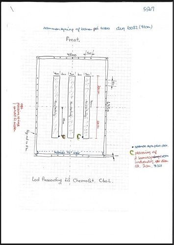

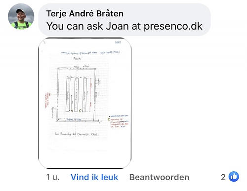

Over on the MLU FB group Cyprien Ouvrard from France asked about a canvas cover for his C60L. Terje André Braten from Denmark shared a drawing with dimensions. I am posting it here for future reference. The canvas has three strengthening strips in the middle.

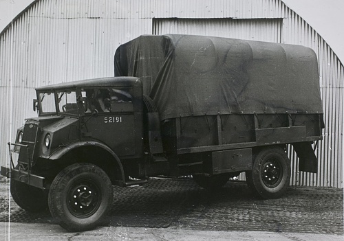

Meanwhile, I responded:
The 3-ton canvas is just a rectangular piece of canvas. The ends fold over to close the ends. If you have the dimensions any sail maker can make one for you.

Some have a second row with eyelets so you can fold the lower ends of the canvas when the bows are in the lowered position.

Canada carrier over that hi/lo system of tarpaulin with the M135 Deuce of the 50s. It was not featured on the US trucks...just Canadian.

I'm 6'2" and i set the hoops at a hight that i can walk down the center without scraping any hair of off by head, I like to keep what little I have up there. The original dimensions are listed in the parts manual, there were a lot of different ones but most are rectangular like the drawing above.
