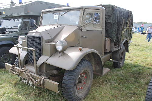

Here’s a picture of an early F15 that was at Beltring one year, note the 2A1 body. I had the opportunity to buy this truck some 16 years ago un-restored from a previous owner. It had an interesting history in so much as it was very low mileage and had been used as a run about on a large Berkshire country estate that had been taken over by the SOE during the war. The story went that the truck was left behind when the unit pulled out at the end of the war. It then worked for a couple of years in the estate wood mill before a fault with the distributor put it into the back of the shed where it stayed until bought at sale in the mid 1980's. The truck was totally original when offered for sale to me.

Another picture of the same F15, taken by Phil Waterman at Beltring in 2001:
Source: http://www.canadianmilitarypattern.com/
I must admit not seeing it that year, I probably was too occupied with my own Ford...

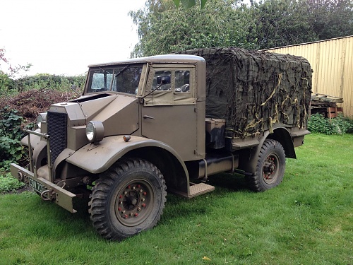

Now owned by Ian Roper:
Edited to add 2nd picture:

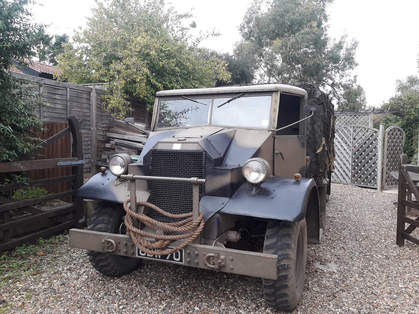

Old 03-09-19, 21:25
Recent pic of Ian Roper’s F15:
PS: threads merged and posts copied to get all info on CBW 70 in one thread
