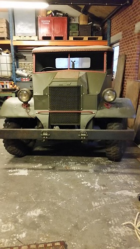

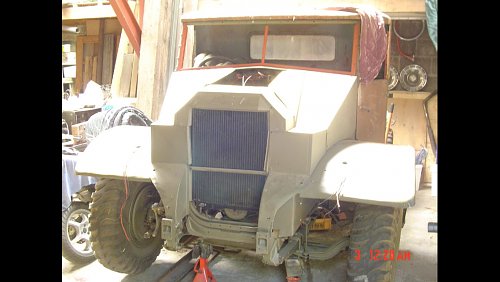

Reading your description somehow did ring a bell: is it this truck? Then it is a C15.
Old 26-05-17, 13:50
Same here!
John, if this is indeed your truck..than you have certainly bought a nice Chev!!!
Alex does your remark on the body means that there where no C8 with the 2A1 body?
That's correct; a C8 would originally have had a 1A1/1A2 or 1B1/1B2 body. bodies starting with "2" were intended for the 15cwt trucks.
A quick way to tell a C8 from a C15 is the wheels size and the cab step...
A C15 has 16inch rims, a C8 has 13inch rims. C15 has a cab step, C8 does not have a cab step. There are lots more differences, but this is a start.
John, a picture of the engine would help....is it a 216? or could it be a 235? There are a few websites that cover engine numbers and casting numbers. I wonder if "0R CH dP" would indicate a rebuild at some stage (?)

This helpt indeed the cab has steps and the wheels have 16 inch rims! With the 2A1 body makes it more than likely that it is a C15!
That is indeed the picture of a previous advertisement of the Chevy I bought. I had a expert with me who is restoring old cars (not military) and he had the impression that the restoration was done with great care.
So I am a proud owner of a early C15 still very nice;-)

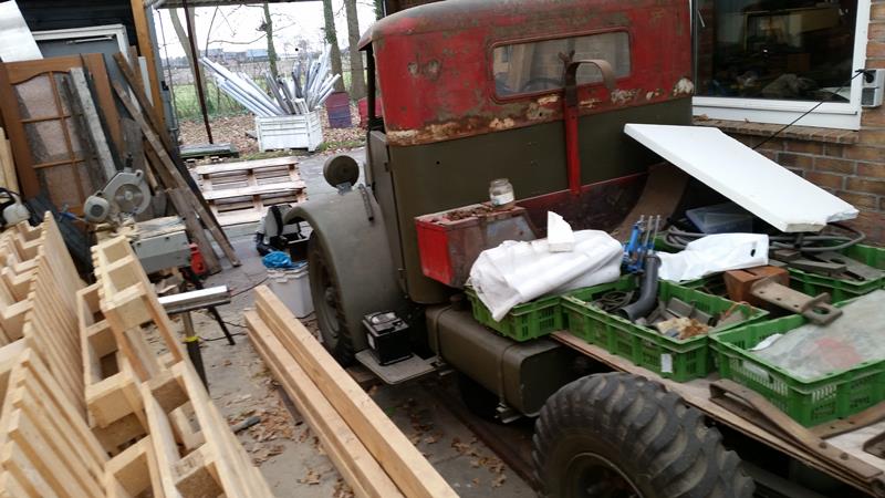

Question remains now with pictures;-)
Chevrolet C15 Cab 11 2A1 body
Lest We Forget

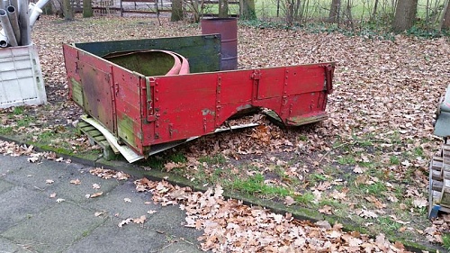

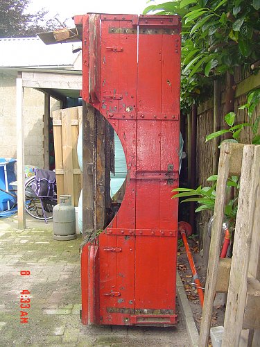

foto's of the 2A1 body...(remains)..
Lest We Forget

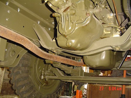

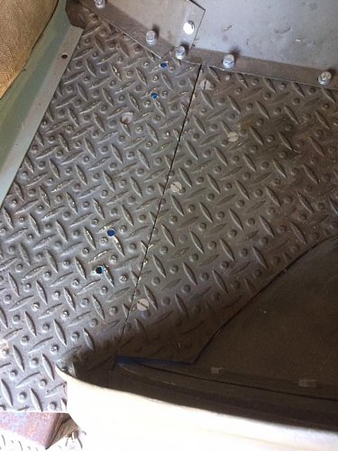

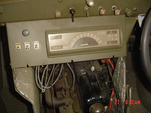

Here are some more pictures I got from the previous owner. I think you bought a great project truck with much of the hard work done.
ID:	91710 Click image for larger version
ID:	91712 Click image for larger version
ID:	91713 Click image for larger version

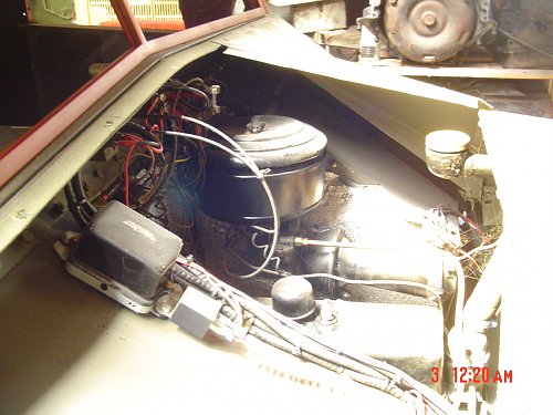

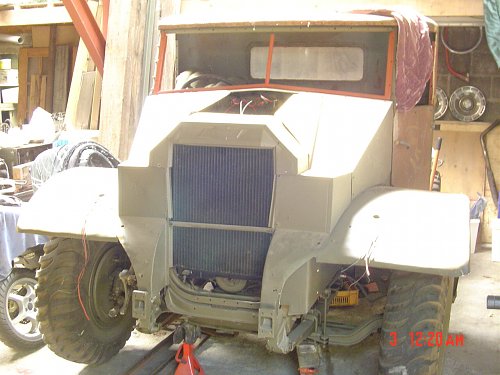

Found some more pictures from before and during its restoration:
ID:	99597 Click image for larger version
Source
