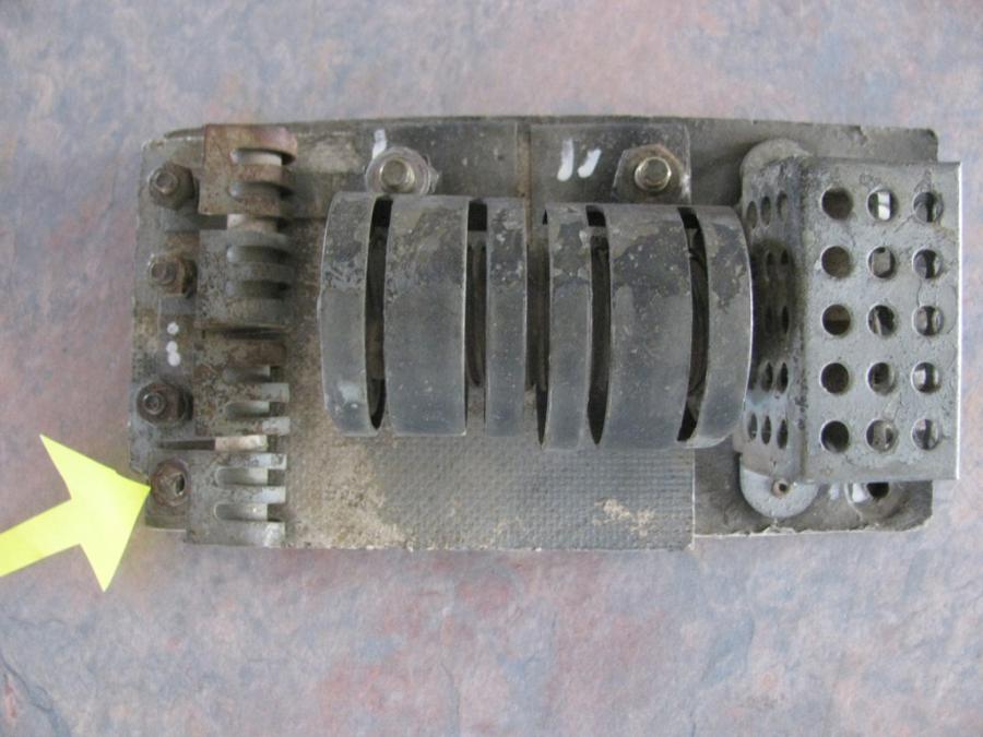

What I do not understand is that the mounting bolts earth out the resistance as the mounting bolt goes through the casing of the coil cover which is on an insulated block. How does this work or am I missing something as I an not an electrical engineer.
Name:	Lynx resister unit 018.jpg
The current comes off the 6 volt resistance coil via a metal strip which links the two further coil voltage reducers to the mounting bolt which goes to earth.
Would that not cause a short circuit?

Old 24-02-16, 15:14
Join Date: Apr 2011
Location: Cherry Valley, ON
Posts: 554
Default Same quandry
Rick,
Glad that your circuit breaker assembly showed up in such good shape. I will offer my two cents worth, but recognize that my electrical knowledge is even more limited.
The schematics for the Lynx 11 show only one connection on the right hand side of the circuit, and that is for wire 20, which is for the temperature gauge. And that connection appears to be to the second terminal from the top. For the mounting bolt on the upper right hand corner, I simply started it under the top plate, avoiding any short circuit possibility.
I was going to wait until I had the opportunity to visit and view the Lynx 11 at the Canadian War Museum and confirm my assumption. Also hoping that Rob Love may pipe up and offer his thoughts based on his knowledge and access to the Lynx in Shilo.
Glad that you spoke up, my assumptions are just that, assumptions.
Peter

I'm looking at the resiter package on ours now and it has the screw in the top corner. No idea why it does not ground.
It is wire no 22 for the temp gauge according to my manual. Wire 20 is for the LH fuel sending unit to the fuel gauge switch.
I have a job on the go today, but hopefully I'll find some time in the next day or two to pull the guard and do some circuit checking. My wire 22 is coming from the right side of the circuit divider. I should think the coil would be what came off the small resister.
When I re-wired the lynx, I remember thinking it was funny that they ran 12 volts from the engine compartment all the way up to the dash, to then run the 12 volts back to the divider and then run it back up to the front again and twice at that. Once for the 6 volt electrical gauge, and once for the remainder of the gauges. I am running a 12 volt gauge so have the one extra wire tied off at the divider unit.
I note that where your wire 20 (22?) comes off the resister now, it might as well be off the screw one lower. There is no voltage drop from the bottom resister to the terminal that wire is coming from. If the mounting screw was fastened to the top corner and grounded out, it would merely burn out the top resister....it would not effect the voltage at the first terminal. Of course, the race would be what burns out first...the top resister, the bottom resister, the circuit breaker, or some piece of wiring.
More to follow.

I think you have misunderstood the circuit . If you study the wiring diagram, the coil 4 Volts feed comes off the larger resistor . The smaller resistors feed the instruments . Mike

Rick,
I will echo Mike's comment that I think you previously misunderstood which components were performing which task on the Circuit Breaker/Ignition Resistor/Voltage Divider assembly.
I think if you have a good study on the newly provided wiring diagrams that it should make sense (I can send higher resolution images if you would like).
I have also sorted out the question of the mounting bolt providing a path to ground and therefore a short circuit. The mounting bolt is designed to provide the ground and therefore make the Voltage Divider work! I really had no idea how this functioned until I googled "Voltage Divider"
Exactly.

What I do not understand is that the mounting bolts earth out the resistance as the mounting bolt goes through the casing of the coil cover which is on an insulated block.....Would that not cause a short circuit?
Never fear Rick, your prized NOS unit will not go up in smoke! Those paired resistors are not ordinary ignition resistors. If you look closely you'll see they use much longer wire, which means far greater resistance. That limits the current flowing to earth. For example, if each one is 10 ohm, the total resistance is 20 ohm, which means the current flowing to earth will be a tiny 0.6 amps (V = IR gives 12 = 0.6 x 20). Of course, as the voltage drops evenly from 12V to zero, you can tap off halfway to get 6V.
