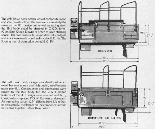

Well I was able to pick up another piece to the puzzle yesterday the hard to find spare tire/tool box and the shopping list is getting smaller.
Just a general question to all of the cmp crowd that has more experience and knowledge than me but how many different variants of the toolbox/Spare tire holder were made as looking through various pictures I have seen some that are welded together, some that has a bit of a cutout on each side where the gas filler neck is and the one I picked up looks for the most part bolted together ??

Posts: 14,934
Nice find!
I think the bolted variant was issued with the Completely Knocked Down (C.K.D.) 15-cwt bodies 2H1 and 2J1, because to me it makes sense to have a tool box which can be flat-packed alongside a flat-packed cargo box.
The ones with the cut-out were for the earlier 2A1, 2B1 (and early 2C1?) bodies to clear the short filler necks on the Cab 11 and 12.

Attachment 77707
Thanks, Its kind of what I thought it would be but was not sure that it might have been a ford chev thing.
