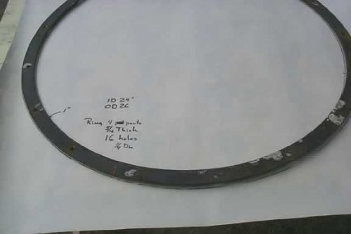

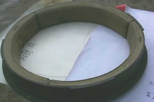

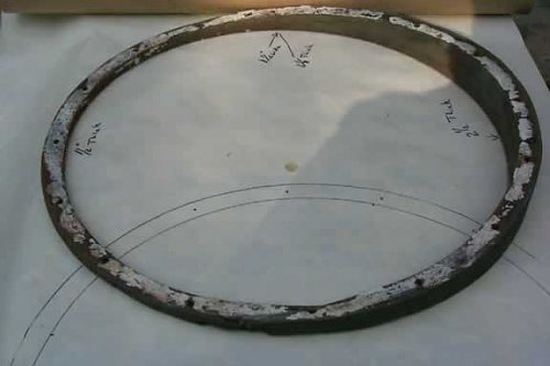

Pattern 13 Front Hatch/Hip Ring Details

Wooden spacer looks to be heat bent oak it is 1-1/16th" in width. At the (looking at picture) 12 & 6 o:clock position it is 1-1/8th" thick, at 3 o:clock it is 2-1/2" thick and at 9 o:clock it is 1/2"thick
These pictures are from http://canadianmilitarypattern.com/Posting.html
The little rain diverters are light gage sheet metal.
