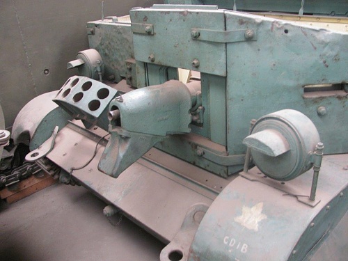

This one seems the one to cover the downwards "droop snoot" as seen on the Wasp:
Source: Flame Thrower
HTH,
