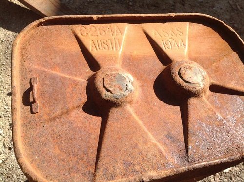

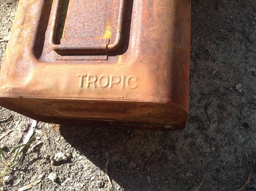

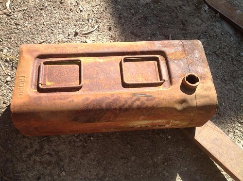

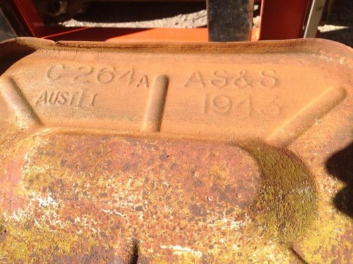

I received an email with these photos this morning and I cannot identify this fuel tank, so over to you experts. Obviously of Australian manufacture in 1944 although it has both 1943 and 1944 dates shown.
Note the handles for carrying it.
thanks Rick.

C264 was an ammo can for 6 rounds of ammo for the 6 pdr gun. It looks like someone cut the end off a second can to make a fuel tank out of it. I doubt it would have been the military....more likely a farmer modification.
Old 27-09-15, 06:03
Thanks Rob, That would explain the two different dates. Well done that man!
Regards Rick.

I have had a few of these converted ammo tins made into fuel tanks. mine also had different dated ends. Our jeep had one in place of the back seat as a long range tank.
