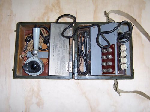

No rush, but when you get a chance, can you post some photos of the insides of that L.S. No.2 Canadian Control Unit Mk I?

Old 15-06-14, 04:03
Sorry, I meant to ask this earler.
Thanks,
As requested:
