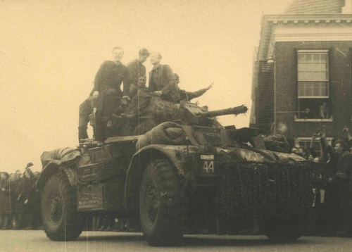

The attached pictures shows a RCD B Squadron Staghound entering Dokkum, Netherlands at April 14th. And a RCD Staghound near Kollumerpomp, Netherlands. The gun calibre looks bigger than the standard 37 mm. version. It is not a 75 mm. howitser version. Does anybody know what version this is?
Thanks in advance.

That Staghound is armed with a 3-inch howitzer. Check here,
https://en.wikipedia.org/wiki/T17E1_Staghound

Another two photo’s from the RCD showing the 3 inch howitzer version.
One taken in Italy, the other in Amsterdam.
