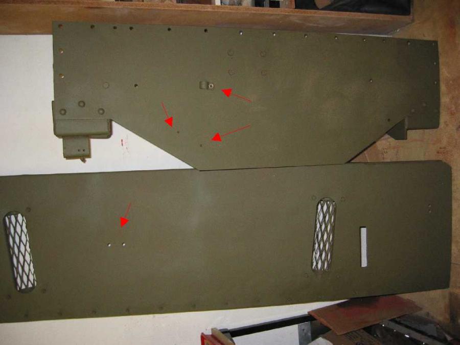

Does any of you have a rearlight assembly as on the attached drawing? I never saw it but this should be valid for Universal Mk.II and Mk.III and I think that I have exactly this on my carrier (well remains of this).
As seen on the attached picture (will send better one evening), there are two diagonal holes on the backplate which, I suppose, are for mounting of the toggle switch box and both lights. On my carrier also back section of the wiring pipes survived so as the clamps pos. 74 and 61.
So I think that switch box should be mounted on the inner side of the backplate with rear lamp (left on the drawing) facing backwards just out of the the backplate and axle flooding lamp (right on the drawing) facing under the vehicle.
Im I right?
