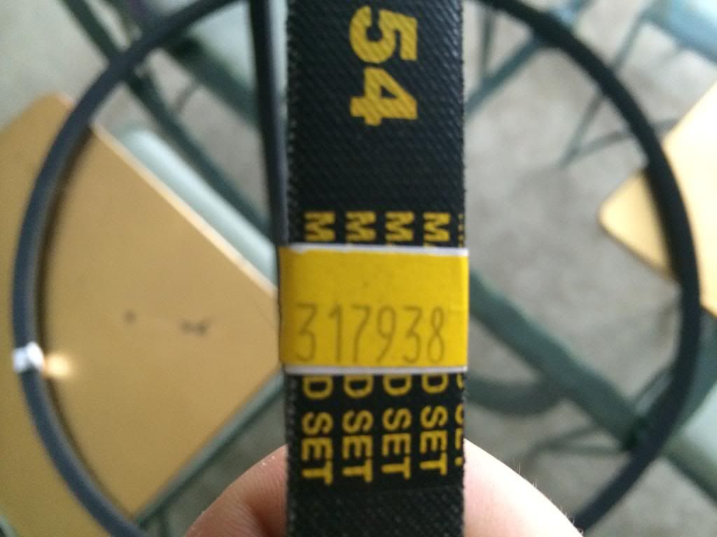

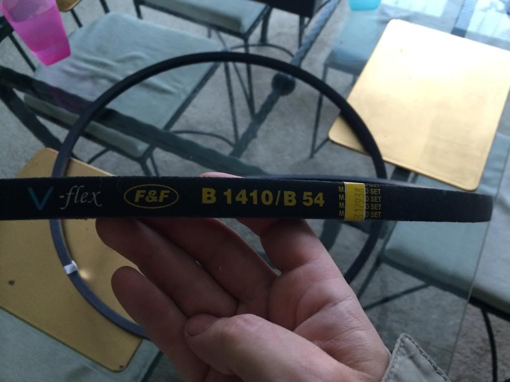

These are the last set I have had, but are too long, I think I have had B52 which I could not stretch over all four pulleys.
These fit into the pulleys perfectly.
