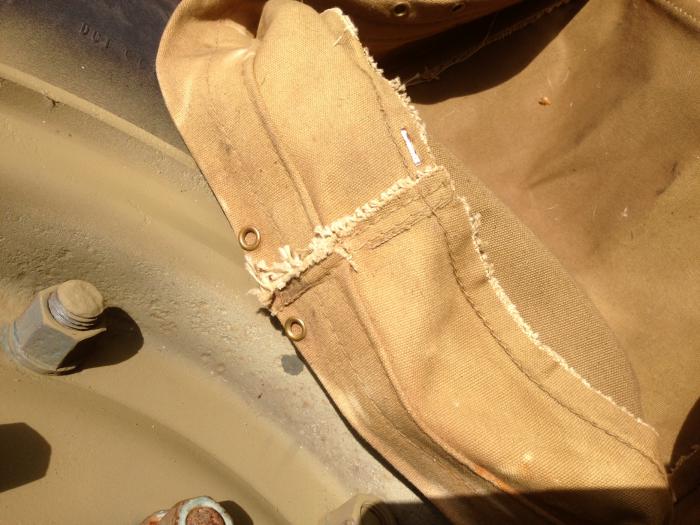

Old 01-09-13, 23:34
Location: Burnaby B.C. Canada
Posts: 1,134
this is the color of the only NOS one I have, kind of a light tan.
inside of seat cover
Old 01-09-13, 23:57
Harry,
Looks like your tan seat cover fits the Light Stone bill....
