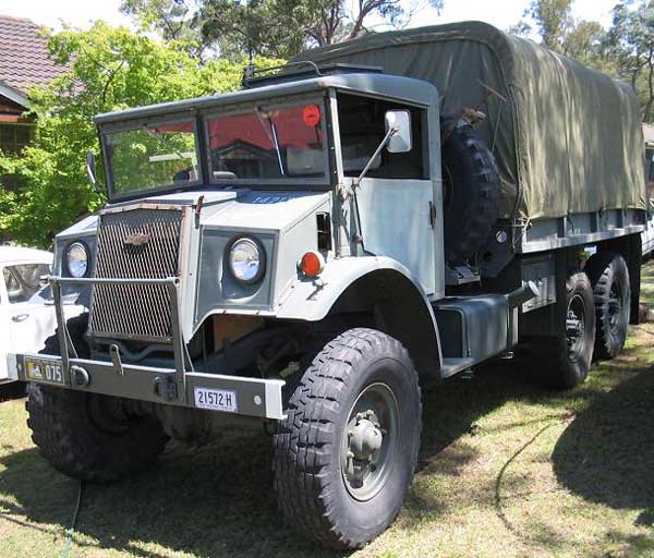

Mainly a question for knowledgeable Aust. CMP owners/MLU members however any assistance would be appreciated. The first attached image displays the spare wheel loading technique and apparatus used on a range of CMPs by 2nd AIF troops during WW2. After the tyre was in place the ramp was stowed under it with the raised section at the end assisting in keeping the tyre in place. The ramp in this instance is a single piece of equipment and the vehicle width at this point was sufficient to accept the ramp length when stowed.
The Australian No.6. Artillery Tractor was designed to tow the Bofors 40mm AA gun after the supply of British Bedford tractors dried up early in the War. It is basically a C60S cab chassis with a locally designed crew cab and stowage binning. All No.6. tractors were fitted with winches.
At the front of the crew cab there is a compartment for a lorry wheel on the left and another for the spare Bofors wheel on the right, drivers side. There is no accommodation for any type of ramp. Documentation on this aspect is yet to surface however I am of the opinion that some form of ramp existed and the most likely stowage spot is between the crew cab and the brake man's seat on the rear deck as shown in image 2. The third image is believed to be one of the securing brackets for such a device.
Problem here is that the available width is insufficient to accept a ramp of the type shown in the first image, basically too short. The contention therefore is that if there was a ramp stowed in said position then it would have been made in 2 sections, either hinged or joined somehow. Can anyone shed some light on this topic.

Bob, check out the new image. Other side is the same. Nowhere obvious that you could attach anything along the sides. The long door accesses three ammo lockers and you wouldn't want anything unnecessary hanging there. Do you have a pic of the No.9. type you describe and is it a single piece construction? Regards ... Rod

Thanks Bob and Cliff. Bob I take your point but I still do not see an attachment point and I have the advantage as I have the Tractor. Same deal Cliff, each tyre compartment is separated and does not have the depth for the "ladder" assembly you allude to. Please see attached image. Regards...Rod

Cliff I have been corresponding with a chap in Sydney who actually drove them in the early 50's. He vaguely remembers such a two piece ladder/ramp on the deck area in the above image. He also remembers the tried and proven method of simply turning it loose and wait until it stops bouncing. In a Unit I was in we had an old International (long nose) semi trailer and the spare was bolted to the curved front section and we used a similar method to dismount the wheel.
There is no room for a ramp under the tyres in either compartment. There is a large pivoting arm mounted at the top of both which prevents lateral movement and each has a steel chock at the bottom with sliding bolts that accept a padlock to secure and hold the wheel in the other direction.
Re your "standard" CMP, 2 piece suggestion...here again I haven't seen an example. The images so far indicate a single piece construction. Add to this is the recent comment from the chap I mentioned above that they recently traded a spare wheel assembly from North Head and it had a single piece ramp. Rod

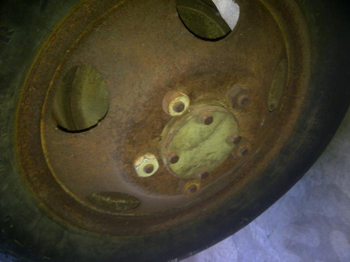

Originally Posted by BSM View Post
Harry they are ex Unimog, 10.50x20's, purchased on ebay from a fellow up North. AUD350 for 5 plus 2x winter treads which we passed on. Not the best profile but necessary. Rod
Not your wheels and tires but the wheels in the picture of the tire carrier in Australia. Exact same wheels on the loading ramp and the front wheel of the CMP. Same as on my thread of looking for a spare for my 20 CWT trailer.

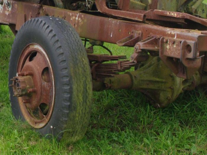

Which one or both? Are wrong. The 20CWT wheels look and are the same as other Canadian trailers in Canada's Fighting Vehicles.
Why would the Australian Army make up a manual or picture of the tire Carrier with an oddball truck unless they were more common than thought. In my Pictures From The Reynolds Collection in Alberta there at least 6 trucks with those Dually's front and back.

The image per Harry Moon listed as 'possible collection in Europe' was taken inside the Melbourne Tank Museum, Australia, and is on a CMP based wrecker. The tyre carrier of this design is unique to Aust production. Note also the Centurion ARV Mk2 in the background.
The period image with the tyre ramp and 'conventional' wheels is of an Australian tipper, viz, 'Truck, 3 ton, Tipper, 2-1/2 to 3 Cu Yd'. There were four main marks (and a number or sub-marks, depending upon the hoist fitted): the early timber bodied version had standard CMP wheels, later versions had 8.25x20 tyres on conventional rims: singles at front, duals at rear. The front wheels could be 'dualled' if the terrain required it. The latter wheels were also retrofitted to the early version from time to time, so there is no hard and fast rule about their fitment. In Australia, the tippers were the only CMP during the war to be fitted with conventional wheels and 8.25x20 tyres as standard that I'm aware of.
The 'Tractor, Artillery, Aust No.6' (the Aust LAA tractor) was originally fitted with standard CMP wheels, but post war (they lasted until the late 50s), many of those remaining in service were converted to dual rear wheels. In 'Take Post', the story of the 18th LAA Regt, there is a 1955 colour image of two No.6 tractors: one with, and one without dual rear wheels.
Early Aust CMP 20-inch wheel stowage did not include a tyre/wheel ramp: this was a modification introduced in late 1943. Earlier production mounts not fitted with a ladder were not modified. It is therefore concievable that at least early production No.6 tractors were not equipped with any form of ramp to assist with stowage of the spare.
The Aust CMP 16-inch wheel carrier was not fitted with a ramp.
Hi Harry,
It's my guess they just picked the nearest truck and it happened to be a tipper! They were produced in considerable numbers here (judging by the number of survivors) so it's not particularly unlikely. I'm sure Mike is correct in saying: "In Australia, the tippers were the only CMP during the war to be fitted with conventional wheels and 8.25x20 tyres as standard that I'm aware of."
I guess it's possible that dual wheels occasionally found their way onto non-tippers in the field, as seems to have been the case in post war years as mentioned by Keith: "I have seen post-war pics of No6 CGTs fitted with dual rear wheels, a field mod no doubt." However I don't recall seeing any wartime pics of duals on non-tippers.
After disposal of course a great many CMPs were fitted with duals for road use, mostly by dealers I suspect, who offered customers a choice of singles or duals (see ad below). It seems there were several different types used, and I happen to have a couple of the type pictured on the spare tyre ramp. These came off an F60L wreck. As you can see they have 6 cutouts in the wheel centre, unlike yours which have 5 cutouts. I suspect the 20cwt trailers may have used early Ford wheels - I'll post some pics shortly which may help identify.

I see your wheels are 8 stud and look like they would fit on a standard CMP brake and hub.
Old 28-07-12, 01:54
Tony Wheeler's Avatar
Join Date: May 2012
Location: Yarra Junction VIC
Posts: 953
These may not be much help Harry but they're all I can find at present as I don't often photograph commercial trucks.
First two pics appear to show early Ford wheels and hubs fitted to Ford CMP axle, which is fitted to Chev CMP chassis!
Following two pics appear to show early Ford axle fitted to cut-down Studebaker chassis with original tipper, converted into a trailer!
Wheel centres look very similar to yours....not sure about rim width though.
