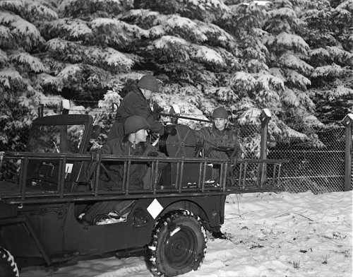

Photos are part of the Laurier Collection. CFB Borden Unit on training in Gagetown NB in 1957. Just an example to show photos of Comm Unit markings.

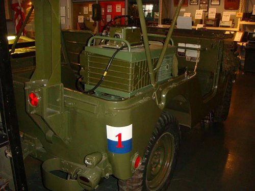

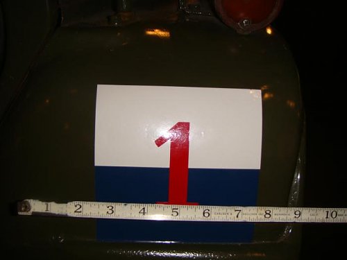

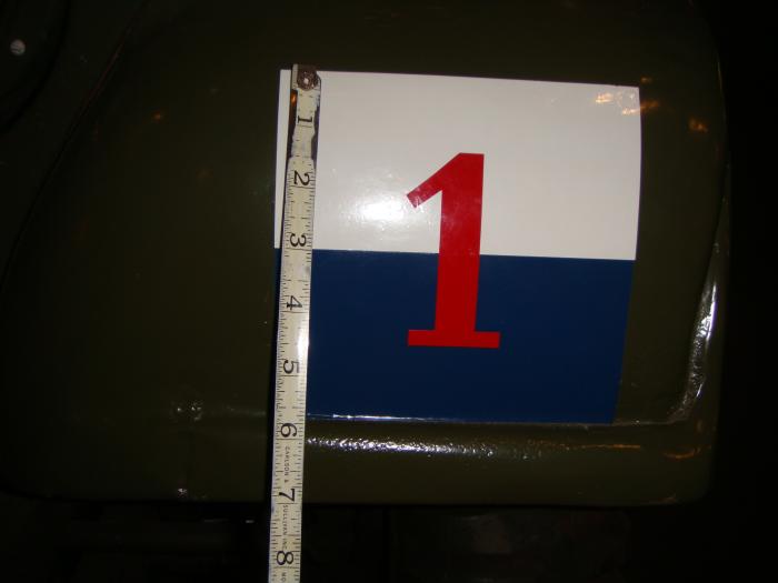

These are the two that I photoed at the museum in Kingston. Both my vehicles are 2 ABN Sigs Sqn. circa 1967. The white number would be 1 and it would be red. I had my decal shop make me some. I can see if they still have it on the computer and make some more up, if you want.

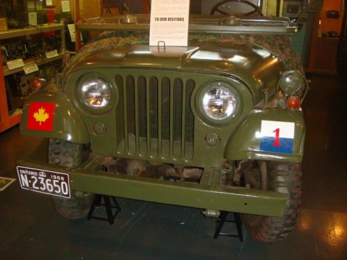

A couple of pics of the M-38A1 from Kingston.
