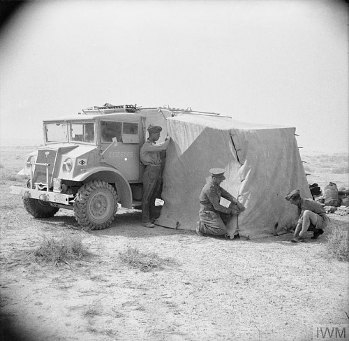

I recalled seeing this frame on 15-cwt truck before, and today I happened to come across a picture depicting the use of this frame.
It looks it was used to attach an office tent to the (possibly both) side(s) of the truck:
Caption: A CMP Chevrolet truck in use by AFPU cameramen in the Western Desert, 28 April 1942
Question: Does anyone know more about this variant?
Thanks!

On the left picture of Vic it is C15 but on the right the truck is F15, Z1326805 on the IWM picture (Cat. No. E 11097) is also Ford. Indeed, in the caption there it is Chevrolet.

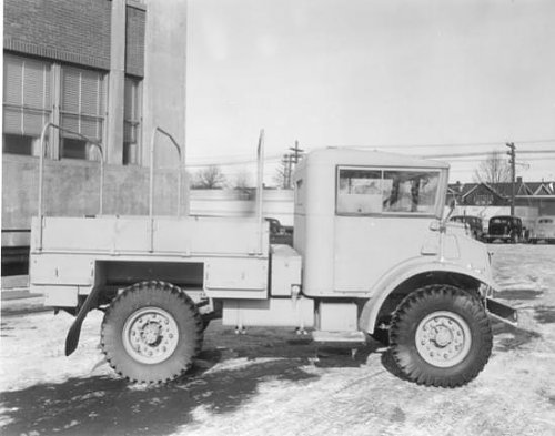

Would it be safe to say the bodies were 2C2?
Last edited by Hanno Spoelstra; 04-07-16 at 11:27. Reason: attached picture, rather than linking to an external hosting site as that will disappear one day

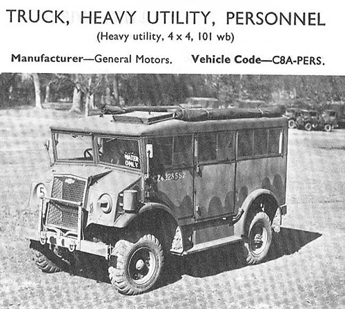

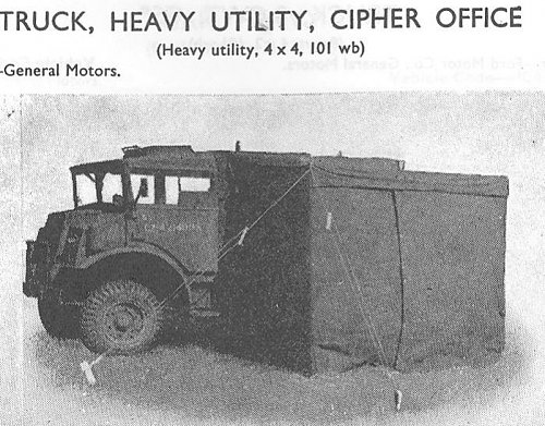

Old 04-07-16, 10:53
The Chev is pulling a trailer. Could these have been Wireless Trucks with early pattern Penthouses?
That's what I thought, but not necessarily for wireless use only: the caption above refers to it being in use by AFPU cameramen.
We know there was a HUP with penthouse - see below.
So the idea developed earlier on during the war may have been the trigger to develop the penthouse. Note how the canvas was rolled up on the roof when not in use. The version depicted below used tent poles to keep the penthouse upright. The one pictured at the top of this thread had a tubular frame plus poles.
ID:	83158 Click image for larger version
The penthouse is a lean-to canvas awning making more office space as shown in the first photo attached to a HUP.
Old 04-07-16, 11:26
Thanks, good tip. But the one at the top of this thread has a 2B1 body, the same as the one depicted below. AFAIK, the 2B1 was not produced as an office variant, like the 2C2 you listed.
So the subject body may have been an in-theatre conversion, though not a one-off. As this filled an obvious need, this was later taken in production as a factory-fitted office body like the 2C2.

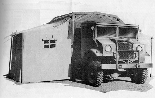

An Australian Army version:
Chevrolet 15cwt signals office (AUST) No 1
Old 30-07-16, 01:31
Default Photos
Attachment 83681
The original of that airbrushed photograph was taken in Melbourne at Wesley Grammar, taken over for the duration by the Army. New types were taken there to be photographed for the various publications.
Old 30-07-16, 11:34
I got this photograph from Les Freathy. Do you have access to any other of these official photographs - I reckon they were used for manuals etc.?

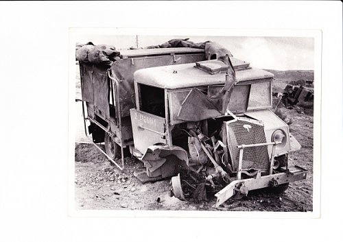

I recalled seeing this frame on 15-cwt truck before, and today I happend to come across a picture depicting the use of this frame.
Here's another picture. Note the frame fitted to the side of the tilt and the penthouse canvas rolled up on top.
Old 20-11-16, 22:22
Default Similar
The mine damaged F15 is not an Aust pattern rear body, looks more like a Canadian 1C1 type. But I agree it's the same configuration.
Old 20-11-16, 22:29
Thanks for the confirmation re. the office configuration.
The body is a 2B1 GS, though:

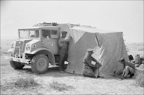

Old 19-06-18, 12:50
Downloaded & cropped the file from the IWM site: https://www.iwm.org.uk/collections/i...ject/205203770
"Object description: A CMP Chevrolet truck in use by AFPU cameramen in the Western Desert, 28 April 1942."
As Ilian said, it is not a Chevrolet but a Ford F15 with WD census number Z1326805.
Note that it has sand channels fitted on top of the roof, just behind the hatch.
Name:	IWM E 11097.jpg
Name:	IWM E 11097 F15 Z1326805.jpg

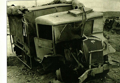

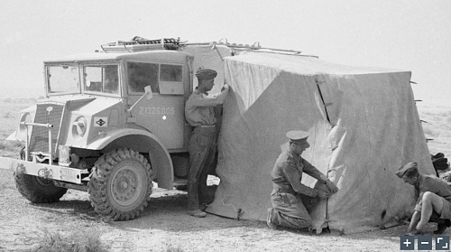

Old 07-07-19, 18:01
Here's a larger print of the same picture of this F15.
Note the wooden planking on top of the tilt, the air recognition roundel and sun compass bracket on the roof.
Have a look at the extensive mine damage - I reckon the driver did not survive the blast, albeit not without grave injuries...

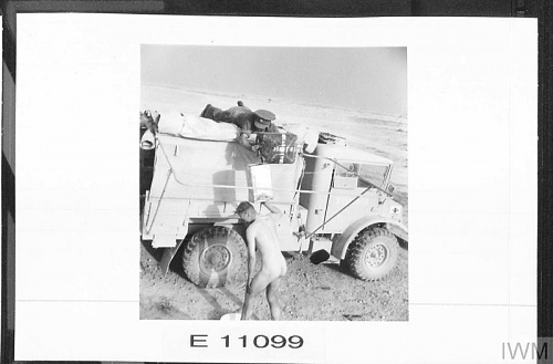

Default Afpu
Mariano found a new picture in the IWM database:
THE ARMY FILM AND PHOTOGRAPHIC UNIT
A Section Leader improvises a bath in the Desert.
30-04-1942
Name:	IWM E 11099.jpg
ID:	126799 Click image for larger version
Source: https://www.iwm.org.uk/collections/i...ject/205551697

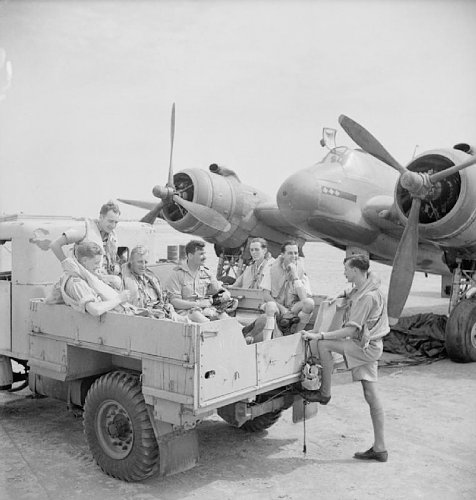

“Drivers prepare a meal outside a Section Leader's tent.”
Source: https://www.iwm.org.uk/collections/i...ject/205551696
