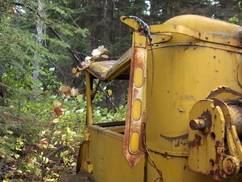

Looking for info on the item in the photo. It looks to me to be a turning signal of some sort. The truck in question is a Ford wrecker that is located in the Yukon. Does anyone have info for this instillation? And was it from the war era or something that was added post war.

Rob,
That would almost certainly be a post-war mod.
Here in Australia post-war all the left hand drive American vehicles required a similar signal because the driver was on the wrong side and his hand signals could not be seen by following drivers. As this truck is right hand drive in Canada it would be fitted for the same reason.
Looks like a rod went across the back of the cab to a handle for the driver to operate.
Lang

That's a very fancy looking version, so Lang is probably correct, but ...
When RHD trucks were used in Europe during the war they had very similar equipment on, but a bit plainer, for exactly the same purpose.
So, it's a remote left turn signal for RHD vehicles, and it looks post-war, but date uncertain unless there is a date somewhere on it.

Quite a few LHD civilian registered WW2 Jeeps here had a mechanical arm fitted across the windscreen where the riflle bucket would be . I had a Jeep with one fitted, some of them were quite fancy with a lever that moved the hand up and down for displaying the STOP sign, or alternatively, the RIGHT turn signal with the hand horizontal . The hand was normally a bit of tin cut out in the shape of a hand . I think the army here might have used them post war as well, but not sure .

I have seen similar setups on many CMPs. I was told that in Saskatchewan, it was mandatory for the right hand drives. There was a lever mounted inside on the roof to actuate the outer arm.
I have never seen one with Khaki paint on it, so I assume it was only installed in civilian use. Note that even today, the DND's vehicles in Canada are exempt from the requirements of the provincial governments with regards to safety inspections and requirements of the HTA. Many of the vehicles were not made to DOT standards either.

That sort of turn signal manifested itself in British civilian vehicles during at least the '50s.
They were called trafficators and I had them on my Morris Minor, Austin A40 and Hillman Minx.

Thanks for the info. On this particular truck the paint is original as it was RCAF. A lot of these trucks, including the one we're restoring ended up in the Yukon after the war. So I'm wondering if the mod was done to allow them on civvy street at that time. A friend of mine has kindly removed the whole unit and is bringing it back to to the valley next week so I'll be able to check for a manufacturers date. On this one, the arm was connected to a cable of some sorts and there is a bracket, missing the arm inside the roof
There also is a fair lead bracket in the back of the cab roof and I can't seem to be able to load that picture right now but I'll keep trying.

We had one of these turnning signals on our 1948 Dimond T truck . At the time there wasn't many electric one's around .Can't remember who made them .We just pulled on the cable .All the way up was right turn ,straight out was left and down was stop .We later switch to electric ones with the arrow in them .I have that kind on my 15CWT .You can't see them from a 100 ft back . Try Guide Co they might have made them . George

Most Studebaker US6s in Australian Army service were fitted with an elaborate mechanical signal device that mounted across the top of the scuttle in front of the windshield. The main tubular support sat on two shaped wooden blocks and was secured to the truck with a dozen bolts. Further support was provided by a fabricated bracket that bolted through the bodywork forward of the r/h door. All of this along with the control box screwed down onto the top of the dash and holes to get the cable from inside to outside makes for a hell of a mess to tidy up and get the truck back to original. Especially so as the kit (which came as a complete set in a wooden box) was often very roughly installed.
