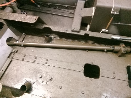

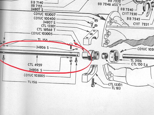

Does anyone have a spare, or drawing for the, gear change linkage (CTL 4959 - the cross drilled tube under the engine between the gearbox and gear lever)?
Mine seems to be a made up part, the end isn’t cross drilled, but is a sliding split collar and it is a nightmare to align correctly, plus it keeps moving out of alignment with the result of losing my gears.

As for the speed change tube, do you have the necessary connections on the parts at each (opposite) end?

Thanks for the info on the seal, I will take a look at the threads. It is the transmission extension that I’m referring to. I haven’t refitted the leather seal yet, and driving the carrier about a bit caused a fair bit of oil to leak out. So before I refitted the engine covers I wanted to check if there was a seal on the gearbox output shaft or the axle input shaft which should be replaced. I think I will seal up the extension with some self amalgamating rubber tape and put the leather seal back on.
Re the gear selector tube, I have both the male ends (gear shift lever and gearbox ends), I just need the tube in between. I have a tube of sorts but not sure it’s the right length, and it is not cross drilled on the gear lever end. Hence I keep getting issues with the gear lever coming out of alignment. An accurate drawing would enable me to make a new tube, but an original would be better if anyone has one.

Tom, Basically you need to reverse engineer it unless you have a good sample. Get your self a suitable bit of morris minor exhaust pipe, 763mm long.
The two outer holes should be about 732mm centers and are approximately on the same plane. This might test you a bit, plotting the other holes.
If you can borrow one, do so and make a jig to fit it, so that you can copy it. If not, you might put gear box and lever in a gear and with two bits of pipe and a bit that fits inside so that you can tack weld and check it for length and angle and use it for a jig when you have it sorted.

Thank you to Michael R for the excellent drawing of his transmission shift tube (CTL 4959). I've made a copy and fitted it to the Carrier. My existing one was about 1/4" too short and the wrong fixing arrangement so hopefully this will sort my shifting issue.
