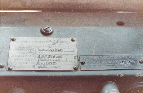

This information comes from the data plate on top of the dash, as fitted to all Chevrolets:
Chassis model | Cab Model | Chassis serial | Engine serial | Order no | Date of mfg

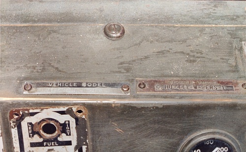

The Vehicle model plate left of data plate on dash:
Vehicle model
Name:	Vehicle model plate sn 3844536670.jpg

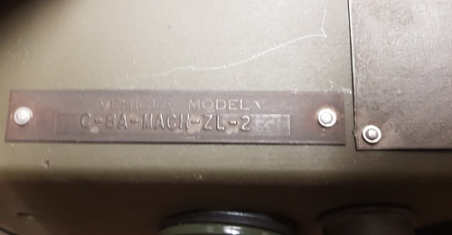

Note: some have a second plate attached to the left of the Vehicle model plate during the conversion to HUM:

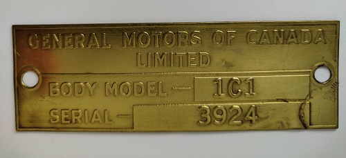

The Body plate on rear of body - this plate was added to all C8A Heavy Utilities:
Body Model | Body serial

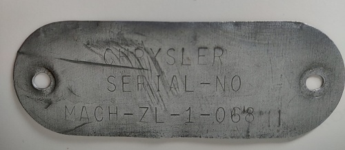

The Chrysler plate on rear of body - this plate was added during the conversion to HUM:
Chrysler Serial-no
